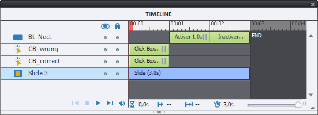

    Here is a better shot. I don't know how to keep it to stay on the slide until the questions have been answered. Otherwise, someone can just click through the whole presentation.
    Lilybiri
    May 5, 2017 5:29 PM UTC
    Give both click boxes a pausing point back, not at the end of the slide, but maybe at 1 sec.
    Let the timeline of the Next button start at 1 sec, maybe its pausing point at 1 sec.
    For the correct click box, choose Continue as action. If the user clicks that box, the playhead will be released, and the Next button becomes visible. It is not necessary for the wrong click box since that has a Jump to action.

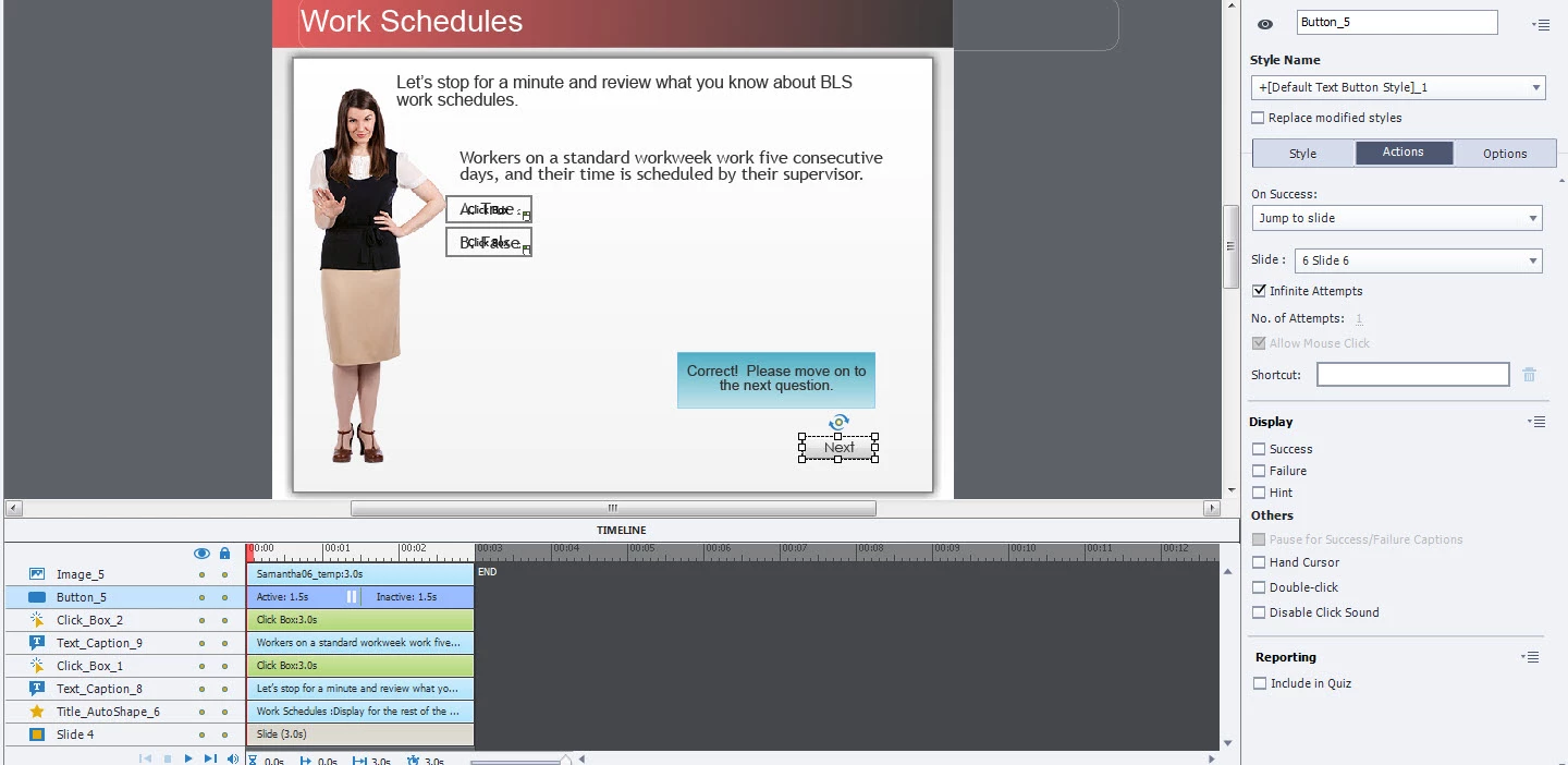

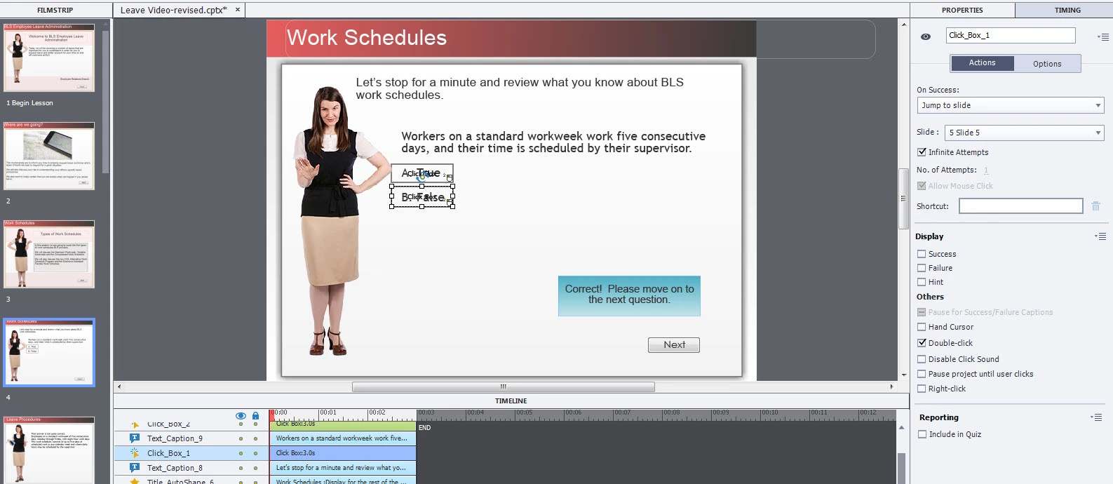

    May 5, 2017 4:02 PM UTC
    Thank you for your feedback. I have provided a snapshot of an example slide. I created a jump to navigation, and it works well. However,
    I don't want the slide to show in the course otherwise. How do I accomplish this?

    The Next button should have the command 'Jump to Slide 6'. If the user has answered correctly, he remains on the slide, will use the Next button and go to Slide 6. If the user answered incorrectly he is navigated to slide 5 and after that slide will go to Slide 6 as well I suppose?
    I cannot see the timeline very well: when is that slide pausing? I see one click box without a pausing point.
