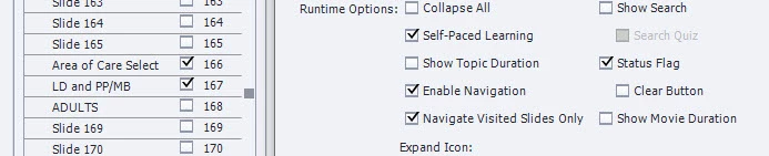

    Question:   I created a slide with 2 buttons (Area 1 and Area 2) when either is clicked, the learner will go to different slides further in the course.     In the TOC, I have it checked in the settings to show Navigated Visited Slides.   When I go through the course after I have selected an Area, in the TOC that slide doesn't have a checkmark as being Visited.     What am I doing wrong?  The Area slide was visited and even interacted by clicking a button.
    RodWard
    Sep 18, 2020 2:10 AM UTC
    The TOC will not immediately indicate that a slide has been visited in certain situations.  For example, if you have three consecutive slides, but only the first one of them is selected to be shown in the TOC, that slide will not be shown as visited until all three slides have been visited by the learner.
    Try going to the TOC settings and refreshing the TOC so that all slides are shown listed in the TOC.  Then do your test again to see if visiting just that one slide now shows it in the TOC.
