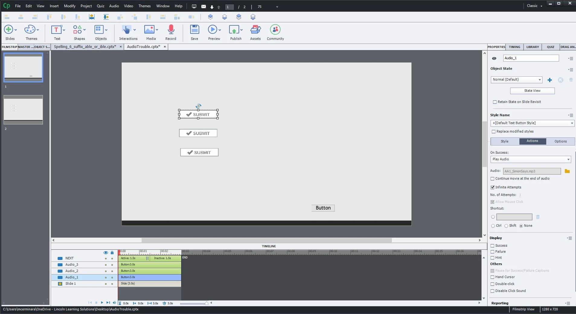

I'm running into an issue with audio attached to buttons. Here's my scenario,I have several audio buttons on a slide. The buttons work fine upon first click. Press a button and the audio file plays. However, if the same audio button or another audio button is pressed before the previous audio is finished, the audio only plays for a brief moment before it cuts out. The best guess I can come up with is that when the second button is pressed it only allows the audio to play for what the remaining time on the first buttons audio was. Has anyone experienced this before?
I'm running Captivate 9. My buttons are set up as "On Success: Play Audio"
I've tried attaching the audio to the "On Success Caption" as well with the same result.

    Hi All -
    Thanks for looking into this problem. I've attached a screen shot of a rough looking design where the audio problem happens.
    Basically my button workflow is this: Interactions > Button > (change the style of button to image button) Actions > On Success (attach audio file)

    How do you play the audio, you talk about an audio button, but doesn't explain that. Is it by using the Play Audio command? Is it by showing a hidden audio object?
    Those buttons have pausing points. Are they all at the same moment (maybe post a screenshot of the timeline)? If you use the simple command 'Play Audio' for your so-called audio buttons, did you uncheck the option 'Continue Playing the project'? Which version are you using? Asking this because before CP9 you couldn't even use a simple action without releasing the playhead.
