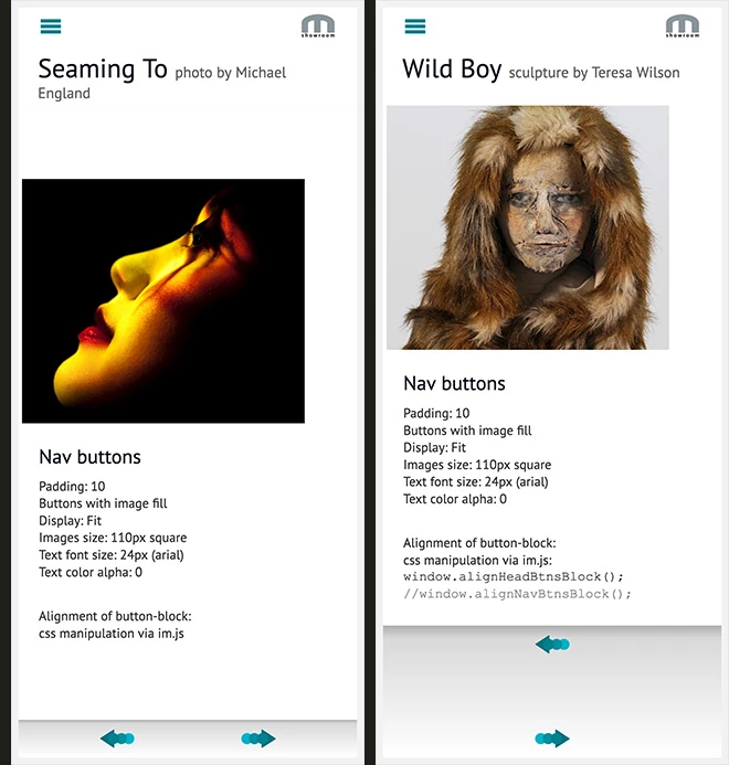

    You are probably doing nothing wrong. The button block from Cp's interactive components just turns out like that when displayed on a mobile viewport.  Even if like in your case the buttons are like small circular items and have enough space to align horizontally. I've tried to attack this problem with a user-defined (custom) Design Option and that worked in the mobile-responsive view inside Captivate but already as a preview in a real browser the buttons went back to vertical stacking.
    The issue is that the buttons in a button block are nested in a HTML division with the class name "cp-buttons-container" and I reckon that this css class causes - behind the curtains - the vertical stacking through a media query setting for mobile-sized viewports. There are as far as I know no alignment options in Captivate to change that.
    This is of cause different in Captivate Classic where you have combined with Fluid Boxes the Wrap Option: Squeeze in a row.
    It is possible though to manipulate the display of the division with the class name "cp-buttons-container" by adding the css-rule style.flexDirection = "row" in runtime via javascript. But before I can give you the necessary code for that I'd need to know more about the architecture of your entire slide. For example how many button blocks are on a slide and where.
    I add a screenshot from a test module I made with two slides in mobile view. One on the left is with two button blocks (top and bottom) where I manipulated the flex-direction for both in runtime. On the right is a similar slide whereby only the top button block is manipulated, the bottom block not. There are actually three buttons in a row - one in the center is an empty invisible button to allow some space. That's why when they stack vertically there's such a gap between the two visible buttons.
