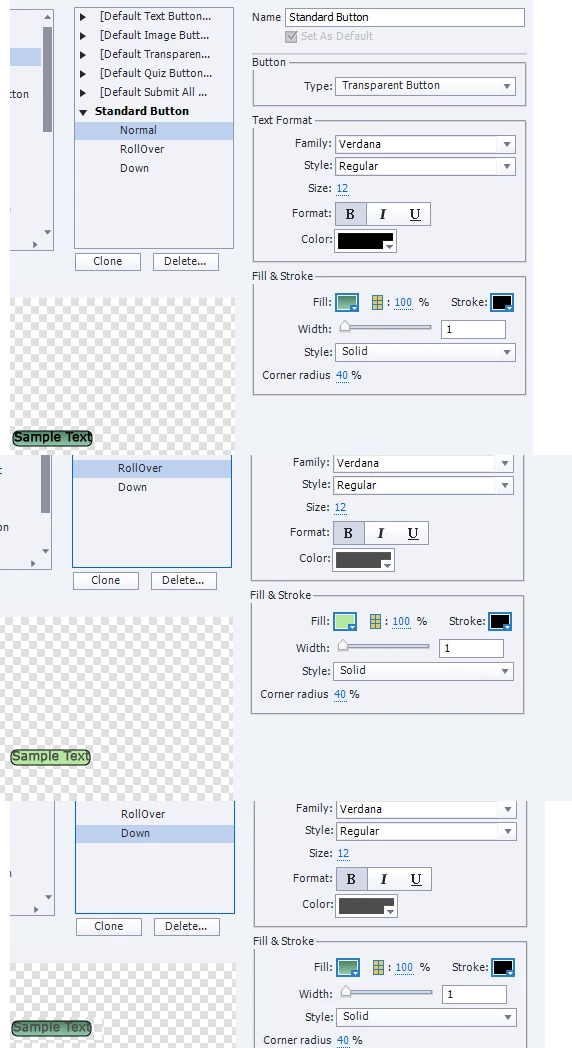

Using the Object Style Manager, I created a button style for use in a program and defined it as the default style.
As shown, the only differences in the states are the coloring of the fill and text.
However, when I attempt to use this button, the over and down states are DISTORTED when rolled over and/or clicked.

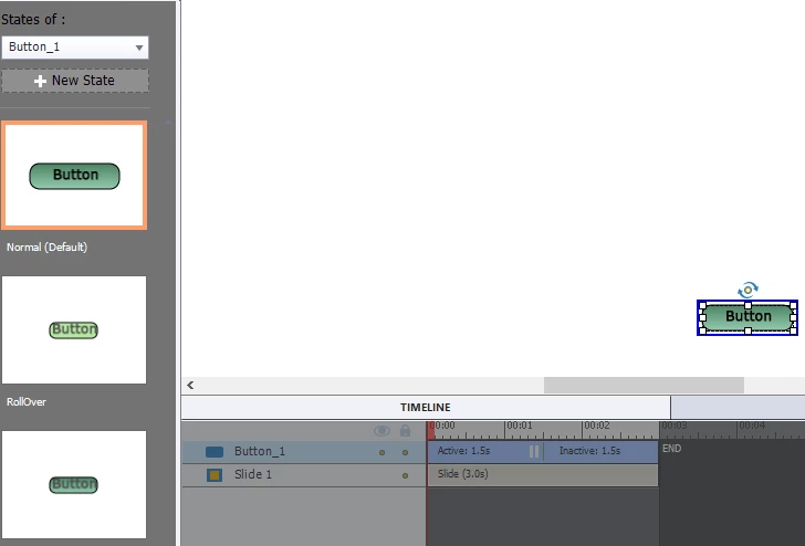

A quick look into the State View reveals the distortion
I have tried resetting the states in the State view, but the states are locked.

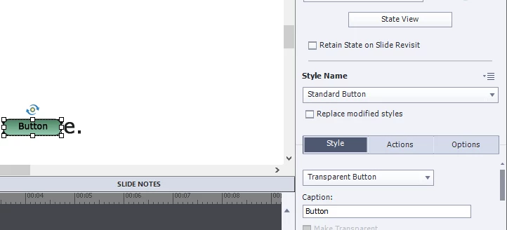

    So, I reset the Global Preferences to deselect the Autosize Button, opened the project in question and reset the Project Preferences as well. Closed and saved project and Captivate. Reopened both and inserted a text button and a transparent button. Resized and moved both.  Checked the State View and found
    Ran the project. It worked. Have no idea why nor did I see any documentation of this step, but that could be me.
