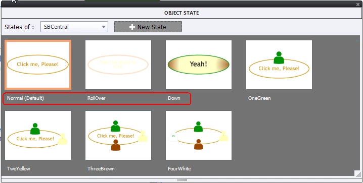

That is what I suspected, because only on shape buttons it is possible to have different labels for states, it is not possible for normal buttons. Rod's answer is correct: you have to check the InBuilt states when you copy a shape button. Look at this State view from one of my blog posts:
If you copy this shape button to another slide, and change the label on that slide, only the Normal state has been changed. I would recommend not to use copy/paste, but to create a style for the shape button, and insert a shape button with that same style on the other slide.
