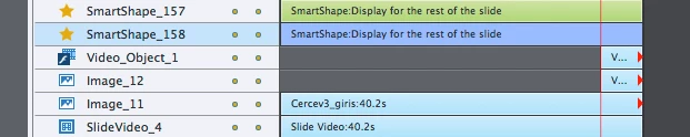

ralantess
ralantessAuthor
November 3, 2016
Didn't work...Both videos are overlapping. event video appears over last seconds of slide video. Slide video's last frame stays till the end. Timeline's stacking order is something like this;

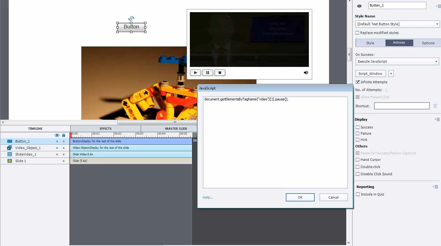

TLCMediaDesign
November 3, 2016
If the event video is not yet encountered when the button is clicked it won't pause.
This is my timeline and JavaScript window and this does pause the video. If I stagger the video so that they don't overlap the index for the video tag is 0.

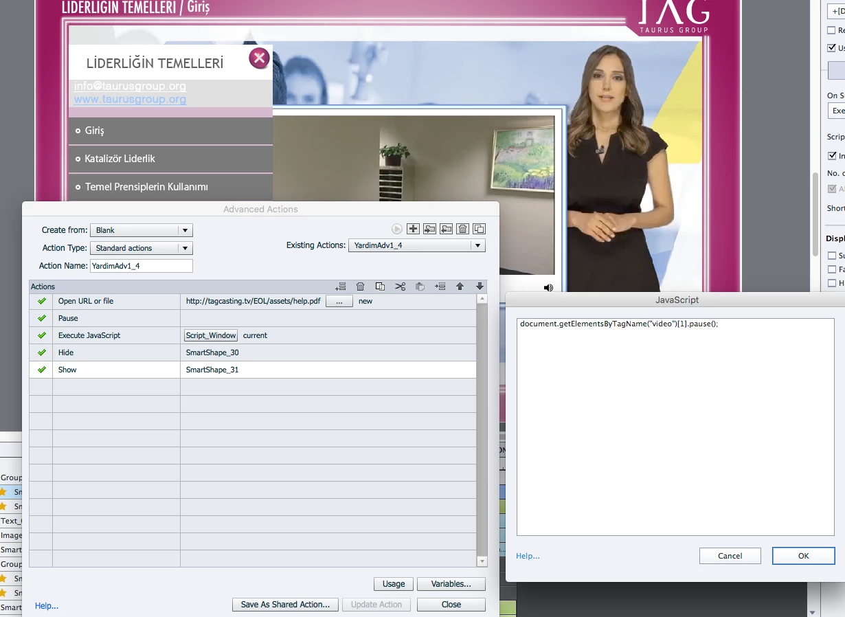

ralantess
ralantessAuthor
November 3, 2016
Didn't work...
TLCMediaDesign
November 3, 2016
So you used this code:
document.getElementsByTagName("video")[0].pause();
It works for me with a slide video and an event video.
Do you have both videos overlapping or playing at the same time? If so you may need to change it to:
document.getElementsByTagName("video")[1].pause();

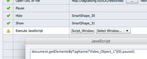

ralantess
ralantessAuthor
November 3, 2016
Hi TLCMediaDesign,
It didn't work. I just changed the name "video". Missing something???
TLCMediaDesign
November 3, 2016
You need to leave it "video" as it's looking for tag names, not element id's.
You also need to select "current" from the select window dropdown.
