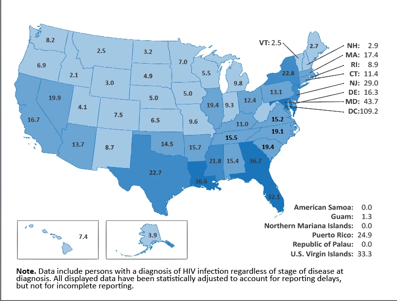

I have prepared several high resolution pictures that I want in my Captivate project.  Though I have exported them as jpgs, pngs and even tried importing them through a photoshop layer, the result is always a extremely downgraded photo quality when published.  I have adjusted the publish settings to export at the highest size and quality but the result is still a pixelated image when published.
On inspecting the 'dr' folder in the published package that contains all the images in the eModule, it seems that the images were all compressed to a much smaller resolution when published.
Is there any way that I could improve the quality of these images?
Example of the published quality discrepancy:
Should be:

    OK, the thing that seemed to help the most was making all my original (vector image) lineweights/text bolder and then saving as a JPG (I was originally using a PNG with relatively fine lineweights).  My new image seems to handle the automatic re-sizing and compression much better than the old one.  It's only slightly larger in size but much easier to read.  BTW, I tried merging image with background and also locking in place, but neither seemed to have any effect.
