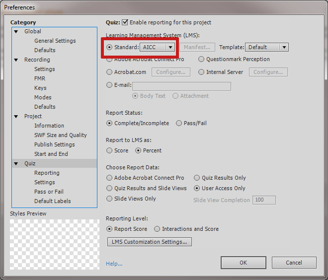

I am trying to call my swf file and SCORM files through the 4 files created by Captivate using AICC in the publishing settings.
These 4 files that are created with the AICC method are:
  • captivate.au
  • captivate.crs
  • captivate.cst
  • captivate.des
I am told by the LMS vendor we use (Cornerstone On Demand) that these are the only files that we can put on their end in regards to using an AICC method to call our files remotely.
Now, if I put all my SCORM files, zip files, etc. on our media server how can I call those files remotely from their LMS server with just the 4 files mentioned above? I don't see how this is possible.
Any help would be greatly appreciated.

One other thing...so for AICC files it states when uploading to an LMS...
"An AICC package needs to be zipped up with the 4 AICC descriptor files (AU, CRS, CST, & DES)."
The thing is...when I publish my Captivate file in AICC format and choose zip.  It zips everything (probably like it's supposed to). However, I would like the swf to be called from my media server.  That way if I change it, I can do that with out rezipping everything and uploading everything in a package again.
Surely somebody else has done this.  It doesn't sound that weird to me to have your large files called from your own server where you have control of them for updates etc.  rather than leave them on somebody else's LMS.
-Brad
