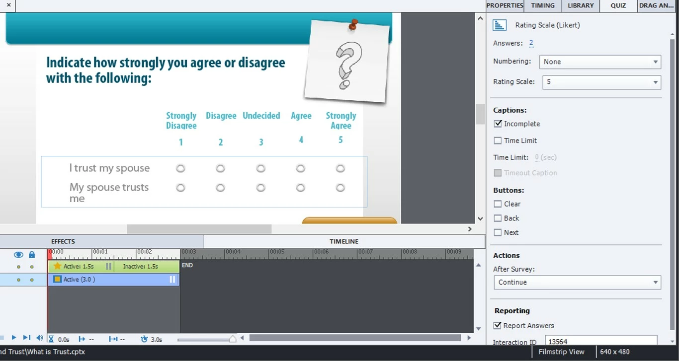

I am using Captivate 8. I am having problems with the SCORM 1.2 question interaction ID.
I have 2 survey questions on the same slide. When it gets reported to the LMS, both questions show up. But, they have the same interaction ID. For example:
I trust my spouse
My spouse trusts me
Both questions show up in Moodle like this:
12345_I_trust_my_spouse  Agree
12345_My_spouse_trusts_me  Disagree
Is there a way to add a second identifier to each question? That would help my queries from the LMS database.
Thanks!
Correct answer Lilybiri
Not AFAIK, because each quiz slide has one identifier...
You could create a custom Likert question, using standard objects and having one interactive object for each question. Each interactive 'object' can have its identifier. But a question slide is considered to be 'one' object, not each answer.

You cannot have two 'questions' on one slide in Captivate, maybe explain what you mean?
June 15, 2016
Perhaps I'm using the incorrect vernacular. I have 2 answers on a Likert Rating Scale question.
Both of the questions and the answers are transferred to Moodle and stored in the database. I would like to add some type of identifier to the individual questions that will allow easier queries. Right now, the interaction ID is attached to both questions.
Is there a way to add additional identifiers?

LilybiriCorrect answer
June 15, 2016
