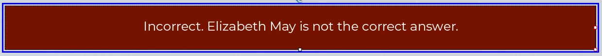

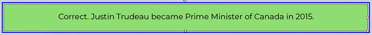

    Consider this though, I like to create a multistate object on my custom question slides called feedback or something similar. It contains a Normal state where there is no text and the object itself is completely transparent. When a learner answers a question my actions for the question set the feedback state to the appropraite version of itself. For example, if they get it correct it might read...
    however if they get it wrong it would change to the state for incorrect messages like this one...

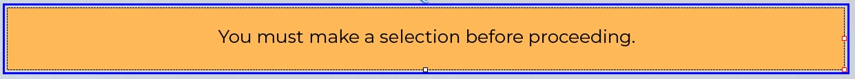

    I even have a state for when they try to answer the question without making a selection first...
    I know it's not exactly what you are looking for but it might be a better solution to what you are looking for.
