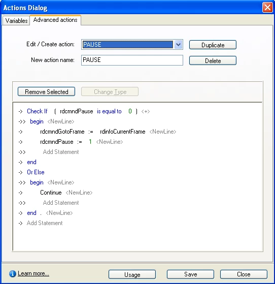

    Hi Lilybiri
    I have applied the same settings. But could not get the result.
    I have to pause & play my project alternaively when user clicks.
    ________________________________________________________________________
    I have tried this way where I could pause my project but unable to play it. I dnt know if it is a correct process or not but what I need is the output.
    Pls dnt consider this one if it is a wrong procedure.
    Kartik.P

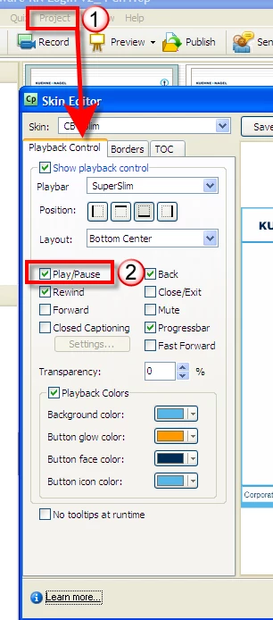

    Maybe I have missed the original request, but if you just want to give the user the option to stop/start your project at a time that suits them...have you considered the playback control options? This is a simple option that allows the user to pause/run the slide as they wish....

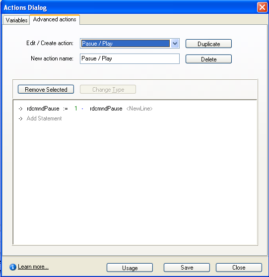

    Do I understand your question all right: you do want a button that toggles, if the SWF is playing the button has to pause the movie, if it is paused, the button has to release the pause and the movie plays on.

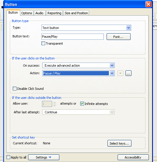

    OK then, create a very simple Advanced action (Project menu) where you do this Assign statement:
    rdcmndPause = 1 - rdcmndPause
    Some explanation: if this system variable = 1, the movie pauses, if it is = 0 the movie plays.
    Forgot to tell that you attach this Advanced action to the button as Success action (if user clicks on the button). Leave the number of attempts for clicking outside to infinite.
    Lilybiri

    Lilybiri
    August 16, 2010
    I tried it out and it works all right. If you do not want a button, you can also replace this by a click box (that is invisible), perhaps covering up the whole slide and instruct the user just to click on the slide to pause or to 'un'-pause.
    As for the construction of the Advanced action (do have a couple of tutorials, but they are for CP5):
    • Open the dialog box from Project Actions
    • Be sure to be on the tab Advanced Actions and choose Create a new action from the dropdown list
    • Name the action
    • Double click on the first statement, it has to become red
    • Use the spacebar to open a list, and choose Assignment
    • From the first dropdownlist choose Variable rdcmndPause
    • From the second list (after the =) choose Value
    • Type in 1 for the value
    • From the third list choose the minus sign
    • From the fourth, choose again Variable and from the list choose rdcmndPause
    • Save the action
    It is a bit clumsy, but the result should look like this:
    Lilybiri
