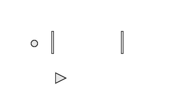

    Perhaps not ideal for you but I think the effect you're looking for could be pulled off with some JavaScript.
    Please excuse my crude example but this is generically what I picture your scenario needs to do.
    If you're interested I could expand a little further and give some code to play with.

    Yes, I can see how it can be applied, for sure. I would greatly appreciate any JS code and guidance, as it may be the way I go ultimately, with this animation.

    Perhaps more like this.
    It is a little smoother.
    It will mostly be about the timing to get  the best look.
