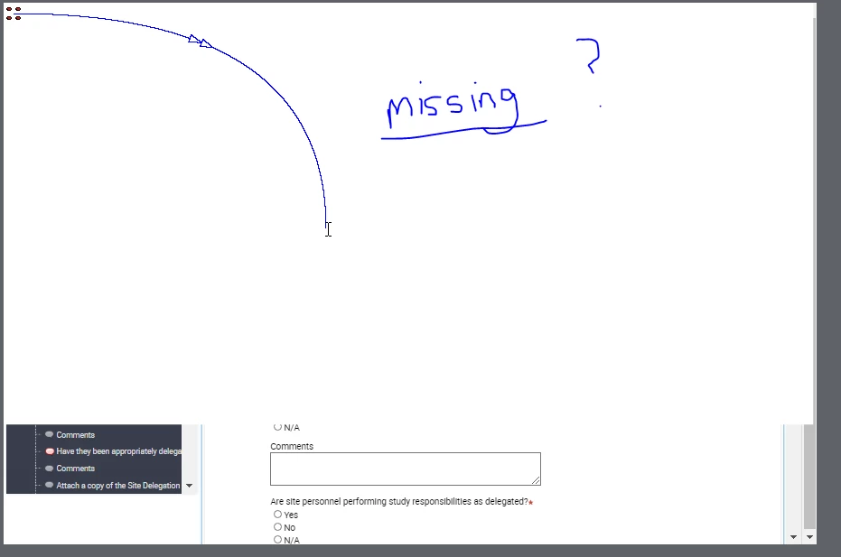

Can no longer paste slides between projects without massive glitches
Hi
I am currently editing some old Captivate training files which were screen-capture simulations-type training.
I have to add new slides of screen recording into an old project, where the screen have changed in some places.
This used to work - I would click 'Record a New>Software Simulation' and then record the new slides which would be created in a new project on another tab. Then I would go into that project tab, copy the new slides and bring them into my old project.
Now when I do this I get a mostly blank slide, with a few strange oblongs of background, and the interactions haven't copied across.
In general I find with Captivate, it saves some of the information about the slide to a completely inaccessible place - it's not a background, it's not an image, so you can't find it in the Libary, it's just some random oblongs which it has decided to save somewhere in between everything and it will decide whether or not it wants to show them.
Could someone recommend a tip for just making this copy/paste function work properly?
This program is becoming increasingly unusable and frustrating as time goes by the amount of glitches in it are honestly ridiculous.
