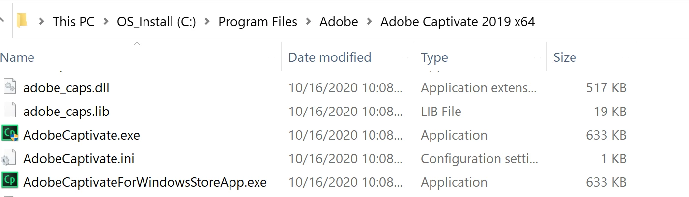

OK,  I know this thread is pretty old,  but I am getting the same Set DpiAwareness =1 in AdobeCaptivate.ini and restart the application" in Captivate 2019. I am Not able to locate the AdobeCaptivate.ini file to even get started with any of these suggested remedies. It doesn't appear in my file list under C:\Program Files\Adobe\Adobe Captivate 2019 x64  Is it in a subfolder perhaps?
Lilybiri
Jan 14, 2021 1:55 PM UTC
No, it is not in a subfolder. It is immediately below AdobeCaptivate.exe:
