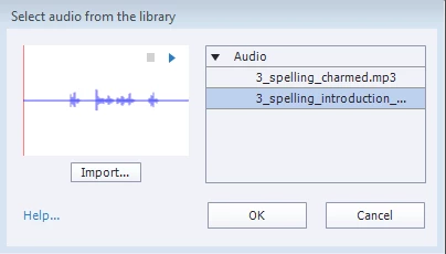

Typical example of not so good naming practice. I always try to explain that the meaningful characters should be at the start of a name.
To what do you want to import: slide or object? You can just drag the audio file to the slide or the object. In the Library you can resize the columns. However if you are in the newbie UI, the Library itself has a fixed width, you cannot make it floating to increase the total width.
This is a dialog box, and those mostly have a fixed size, you cannot increase the width.
Another tip: this is a mp3 file, are you aware that the Library will also have a wav-file? On publishing the wav, which is uncompressed, will be compressed to a mp3. For better quality you should use wav files
