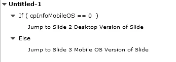

In the instance I'm referencing I wanted to have two versions of a slide that was showing the screen of a smartphone. On the desktop version of the slide, I designed it to appear on a mockup of a smartphone to illustrate that this view was what the end user would see on a smartphone. In the case where the learner was viewing the training on a smartphone, I didn't want to show a picture of a smartphone on a smartphone so I made a version fo the slide where the screen filled the screen. I used something similar to the following advanced action to make it work. I didn't really see it as overkill as the results were really nice and the client appreciated the small but extra effort.

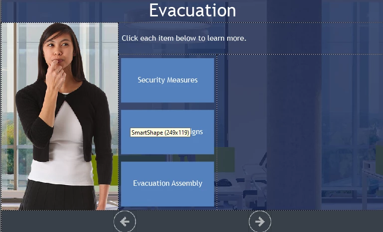

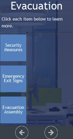

So you can do one or more of several things to customize the view for different devices. Unlike breakpoint style responsive design there is no way to move an object off the stage for a certain device. You can set an object or a child level fluid box to be optional. When the screen size drops below a certain percentage which you set on the parent fluid wrap options that object or child level fluid box disappears. Here is an example where the optional content (the cutout character) disappears when there isn't enough space to display it.
One alternative to this is to use advanced actions and look at the system variable cpInfoMobileOS and have it navigate to different versions of the same slide depending on the value of cpinfoMobileOS.
Desktop = 0
iOS = 1
Android = 2

Apr 26, 2019 4:53 AM UTC
Thanks Paul. Also, I will try using the variable cpInfoMobileOS and see how it works out for me.
