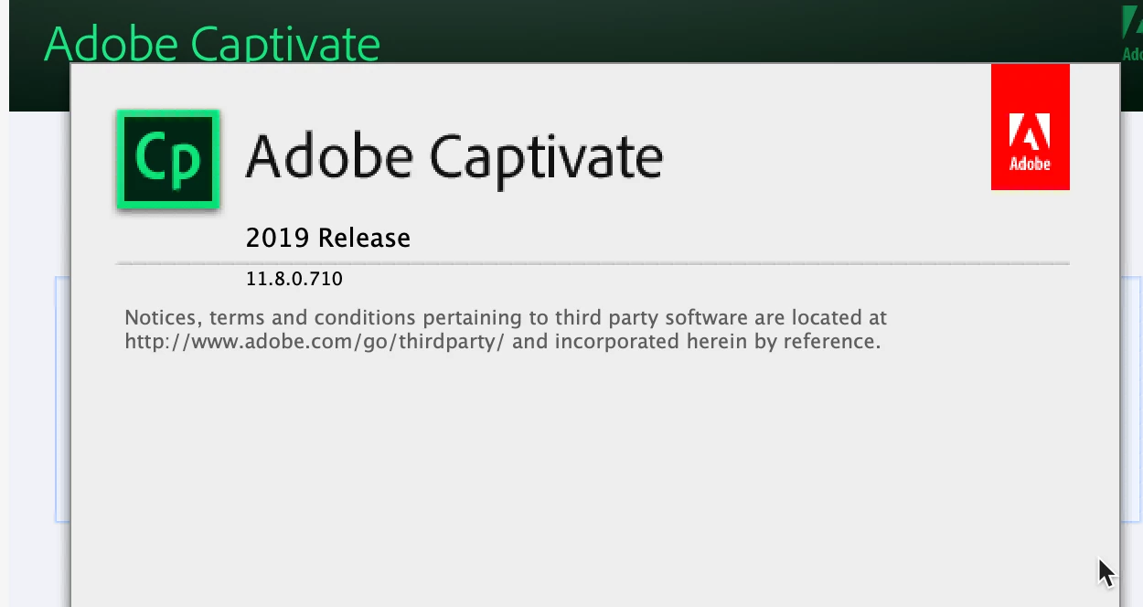

Captivate 11.8.0.710 issues with Monterey 12.5.1.

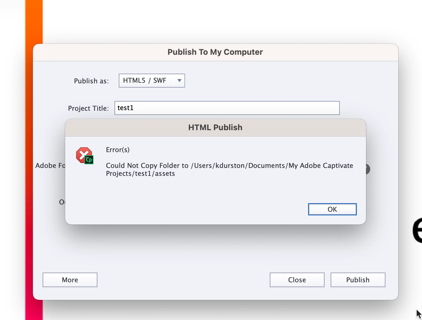

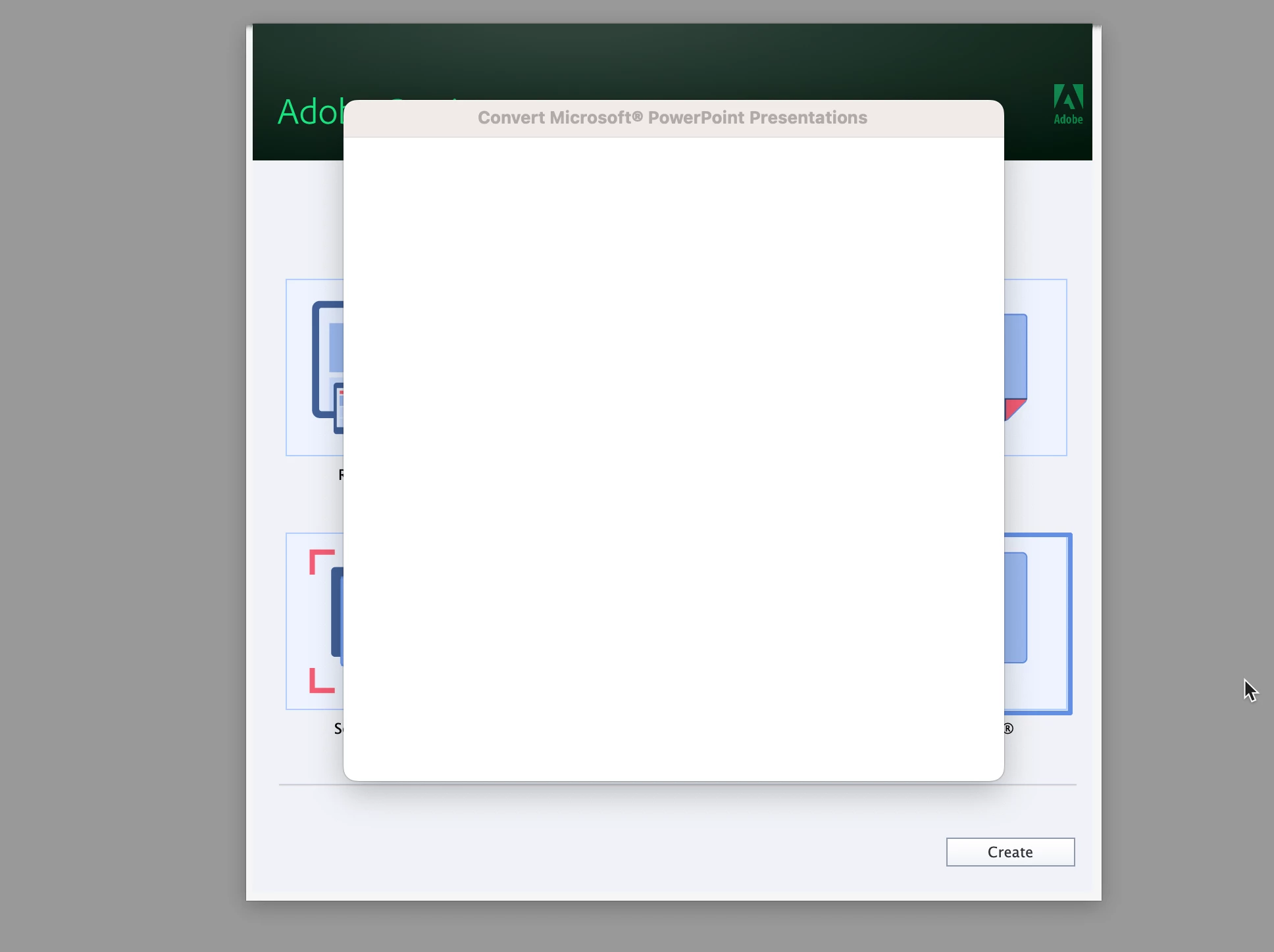

We were thinking of buying Captive so I am trying out the trial version. Two big problems:
(1) I can't import powerpoint slides. Failure mode: see screenshot
(2) Can't publish. Error: see screenshot
I do have openJDK installed. (Adobe support  also installed Oracle JDK).
I had Adobe Support working with me. (They see the errors I mention above). They told me that the problem is conflicts with Crowdstrike Falcon. They gave me a version of Captivate which reports itself as 11.8.0.11. This solves the problems above.  We are concerned that the supported release does not work for us and don't know the status of the 11.8.0.11 version. In a couple sessions, I worked with Adobe Support about 2 hours. The trial version never worked, just the 11.8.0.11.

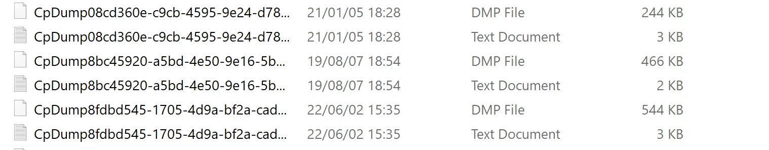

    As for the log files, when a crash happens, they appear in the installation folder on my Windows system. They also come as a pair, as you can see in this screenshot:

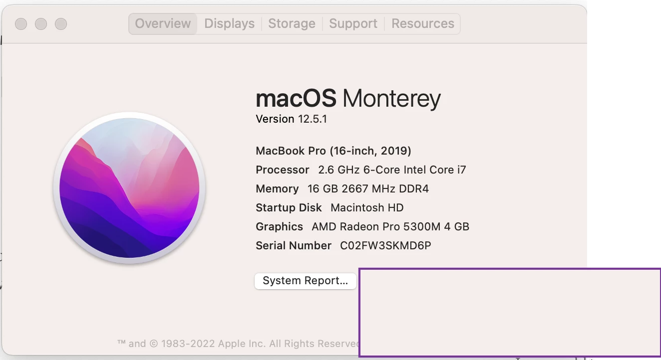

    Thanks!  We believe it is a Monterey issue.  A colleague who is running Monterey 12.2 was just able to do the things I can't do with the same version of Captivate.  He had Crowdstrike running (he is the Crowstrike Admin and we were just trying to get him to the point where he could recreate the issue).  So our current thinking (subject to learning more) is that it is an issue with Monterey more recent than 12.2 (don't know precisely) and NOT an issue with  Crowdstrike Falcon.
