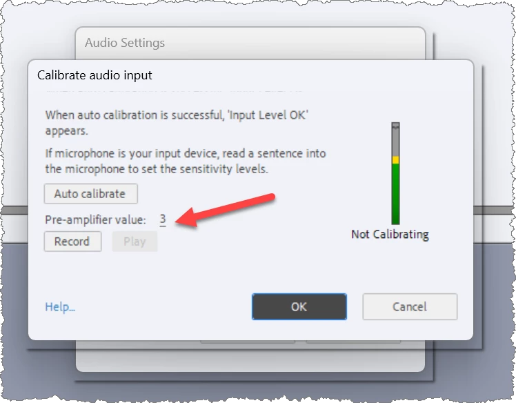

    I never find the Auto Calibrate works well enough.  I always experiment with adjusting the Preamplifier Value manually until I find a value that seems to give a strong enough waveform for a particular microphone.
    Once you find a value that gives you good audio without clipping (cutting off sounds that are too loud) you should be good to go.
    The setting you see above is what I use for my podcast quality microphone.

    Thanks, @RodWard ! I've used that functionality in Classic Captivate, but it's not available in the new Captivate. Yet. I'm going to say "yet" with hope 🙂
