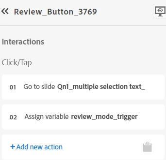

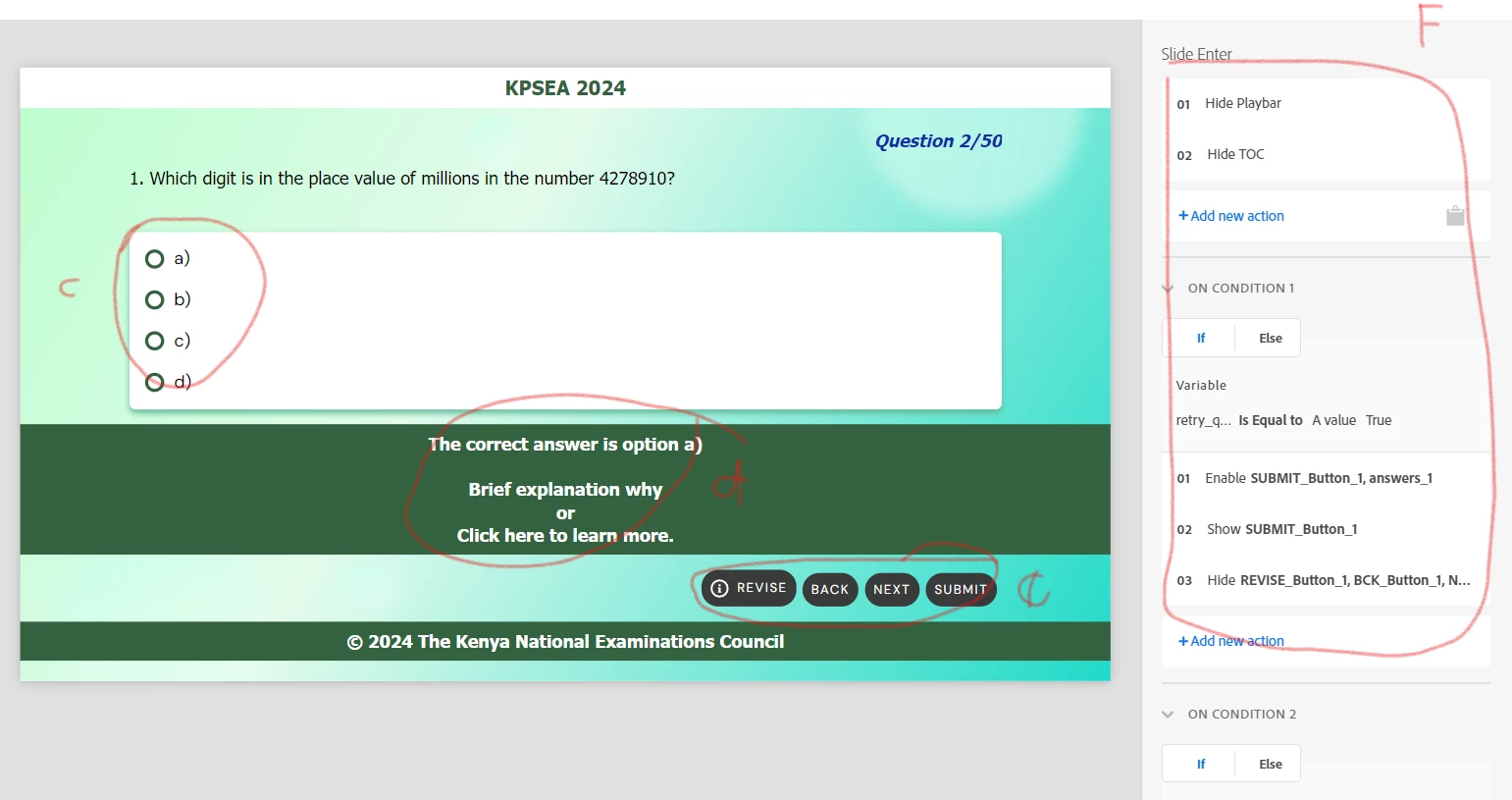

The project requires the user on review mode to be able to click on the feedback message to go to a content slide where they can revise the questions.
However, on the current inbuilt graded question slide, the feedback message on review mode does not allow any interaction.
a) You cannot add any block/element to the question slide
b) the feedback message does not allow any custom navigation interactions.

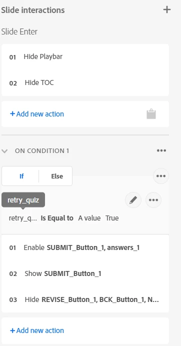

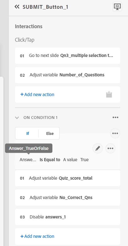

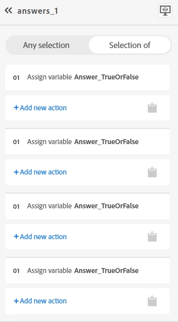

I have used radio buttons to create custom question slides but I have some challenges.

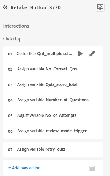

c) the radio buttons cannot be changed to default state on slide revisit when retaking the quiz.
d) the feedback flickers, then dissappears when the user retries the quiz after reviewing.

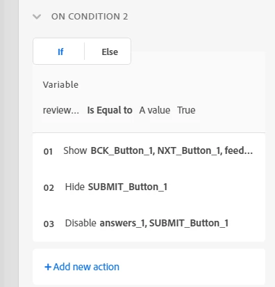

e) the qn slide interaction has two conditions: for retake  and review mode which do not seem to work.
the following are the interations for the question slide: On enter conditions, radio button interaction and submit button interaction.

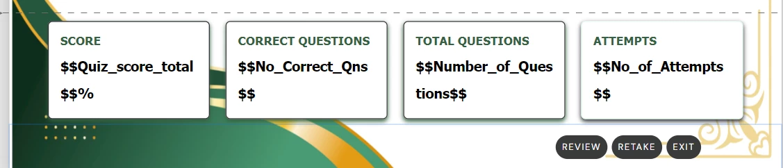

The following are the interations for the result slide:
1. How can i optimize the interactions to work better or IS THERE A different workaround?
2. How can  the radio buttons change state to default on slide revisit?

    apparently, uploading .cpt files is not yet supported here. Here is a video demo of the problem
