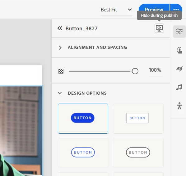

2. In the button interaction click Hide during publish. Create a slide interaction of Show button at bookmark, with the bookmark located 5 seconds from the end of the slide.

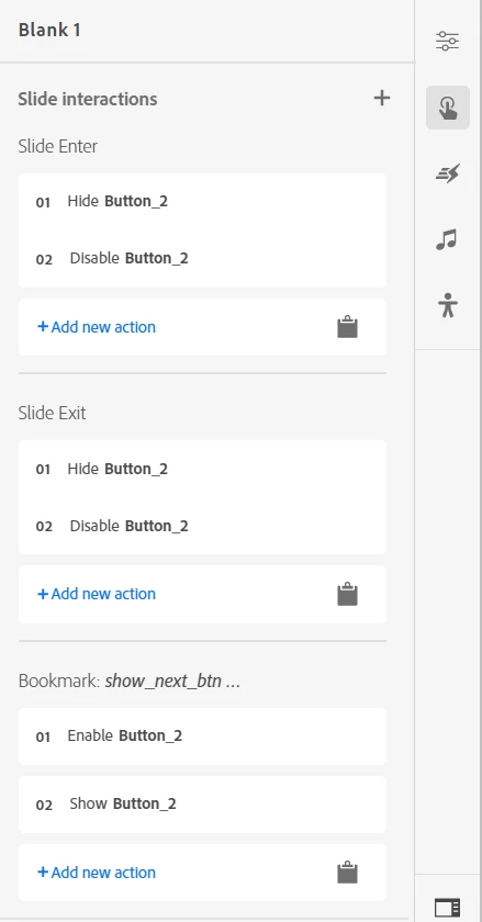

    I get this issue when i duplicate slides with similar functionalities. Possible solutions:
    1. enable next button to show on publish using the eye icon next to properties. then use the on enter and on exit interations. i.e on enter hide and disable next_btn. then have a bookmark at 5 seconds before slide end. This bookmark interaction will enable and show next_btn. Then, on exit disable and hide next_btn.
    Recommendations:
    -Avoid using the timeline to reveal the button, instead, use bookmarks, to show/hide/enable the button.
    -Your second method is conflicting. Make sure the on enter, on exit and any slide interactions do not conflict with the button's interactions.
    -If you have duplicated many slides, before publishing; save the project, clear your cache, temp folders, and then publish it.
