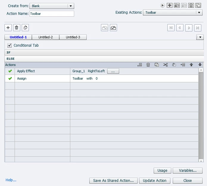

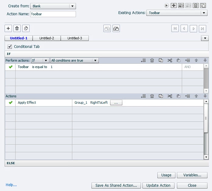

I'm trying to have a button that will remain during an activity of the course to expand and collapse a toolbar reference that will assist the learner in the activity. (kind of functions like a TOC, comes in from the side and when it collapses moves back into the original entrance spot).
Anyway to do this?
I currently have an advanced conditional script going on so when I click the button to reveal the toolbar references it has the effect "from right to left effect " however when I try to collapse it with the effect "from left to right)" it keeps playing the right to left effect.

Logic is not correct in your action.  In such a case you have to toggle the variable in both parts: THEN and ELSE.  What is the star value of that Boolean variable? If it is 0, the action should be:
IF v_toolba is equal to 0
    Toggle v_toolbar
    Apply Effect Left to Right
ELSE
   Toggle v_toolbar
    Apply Effect Right to Left
BTW: the Pr"eview button in the AA dialog box is the first button in the top right control panel (looks like an arrow). Explore this blog post:
