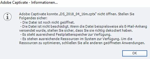

I can´t open my projects created with Cpativate 2017 in Captivate 2019.
I have checked all the error messages (see image attached) and have also searched in Forums but couldn´t find a solution.

    German, understand Goethe's language well, but will not write in it. That is an all-round error message which can be due to many origins. Can you check if there are any files with 'lck' in it, one of the possible reasons mentioned in the message.? It would mean that the old project is not closed regularly. Is probably not the cause if it happens with multiple projects.
    Did you try to clear the cache (Preferences) and cleaning the Preferences?

    Thank you for your quick response. I have just spoken to our IT department again. It turned out that the company has installed version 9 instead of version 2019. Now the have put 2019 and thank god I can open the projects again. Please apologize the inconveniences caused.
