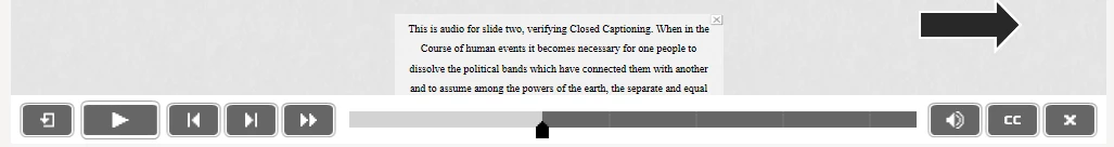

We have just started using Captivate 2017 and we are finding an issue with the Closed Captioning.  This is happening to Cp9 courses converted to Cp 2017 as well as new courses built in Cp 2017.  In the past, the content we had in the Close Captioning field stretch across the bottom of the slide and would allow the learner to read all the content.  However, now, the content is boxed in and does not allow the learner to read all the content.
I have tried going into the CC settings in the Skin Editor, but changing the X Y does not help.  Is this a known defect?  The image attached shows what we are seeing.  We cannot stretch the box out and there is no scrolling mechanism for the learner to read all the content.

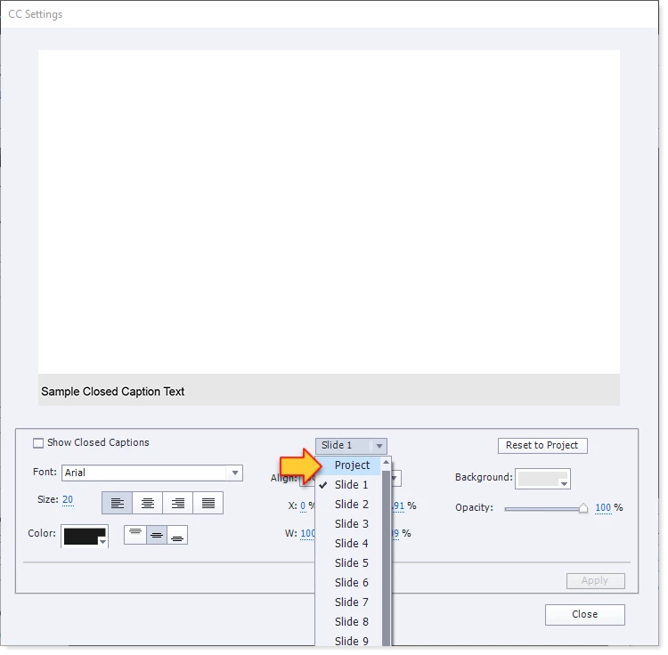

    Open the Skin Editor to the Playbar settings, then get into the Closed Caption in CC Settings dialog.
    Like I said above, the dialog is a bit tricky to understand but if you FIRST set the drop-down menu to Project rather than accept the (rather foolishly selected) default of the current slide number, then any of the settings you make AFTER that point are going to apply to the entire project.
    Personally, I think this bit of the dialog is badly designed.  It's too confusing.  There should be a radio button array or toggle button that allowed you to select whether you wanted settings to apply to the entire project or just an individual slide.  The default should have been Apply to Project, and only if you selected the option for Specific Slide would this dropdown become available.  That (IMHO) would have been a less confusing way to do it.

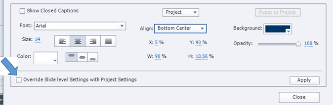

    Found  a way to update the entire project as opposed to slide by slide. Having an Emily Litella moment. Apologies to the Captivate Developers.

    It's still a bad design.  Project SHOULD be the default for the dropdown and that checkbox for Override Slide Level Settings with Project Settings should also be defaulted to ON as well.
    This is another instance where a problem occurs because the Captivate programmers are not actually engaged in building e-learning courses for a living.  If they were they would know that you are extremely unlikely to ever want the Closed Caption settings to vary on a slide-by-slide basis.

    The confusion comes about because the interface now gives you the ability to set the caption size individually by slide as well as by project.  But the default setting you see when you open the dialog is for a  specific slide.
    The trick is to make sure you open the drop down list for the slides, scroll all the way to the top, and select PROJECT.  Do this BEFORE you start changing any of the settings.  Then whatever you set will be for the entire project, not just one of the slides.

    Thanks Rod, this appears to be helpful, BUT, I'm not sure where you are talking.  Where would I find this drop down list to be able to select PROJECT?  I don't see any option like that in the Skin Editor or the Settings therein.  Can you tell me where I'd find this menu?
    Thanks!
