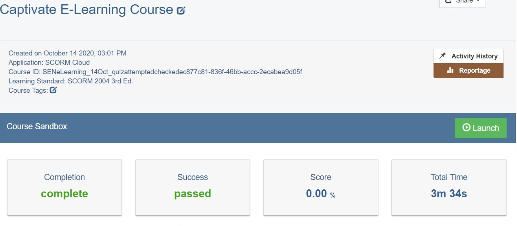

    I also uploaded to SCORM cloud to test and it showed this:
    Wondering why the score isn't showing up.
