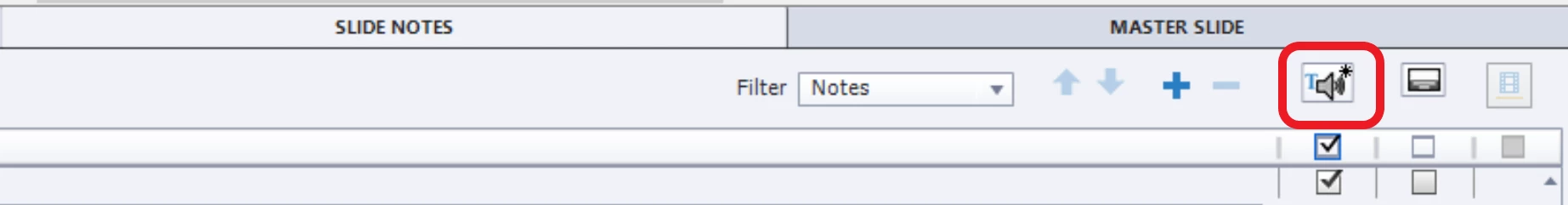

    It should be installed already, maybe you need to add voices. You can open TTS using this button (if at least one slide note has been entered and checked for TTS):
    In the dialog box you will see the voices that are already installed (with OS) but have also the possibility to install the Neospeech voices packaged with Captivate.
