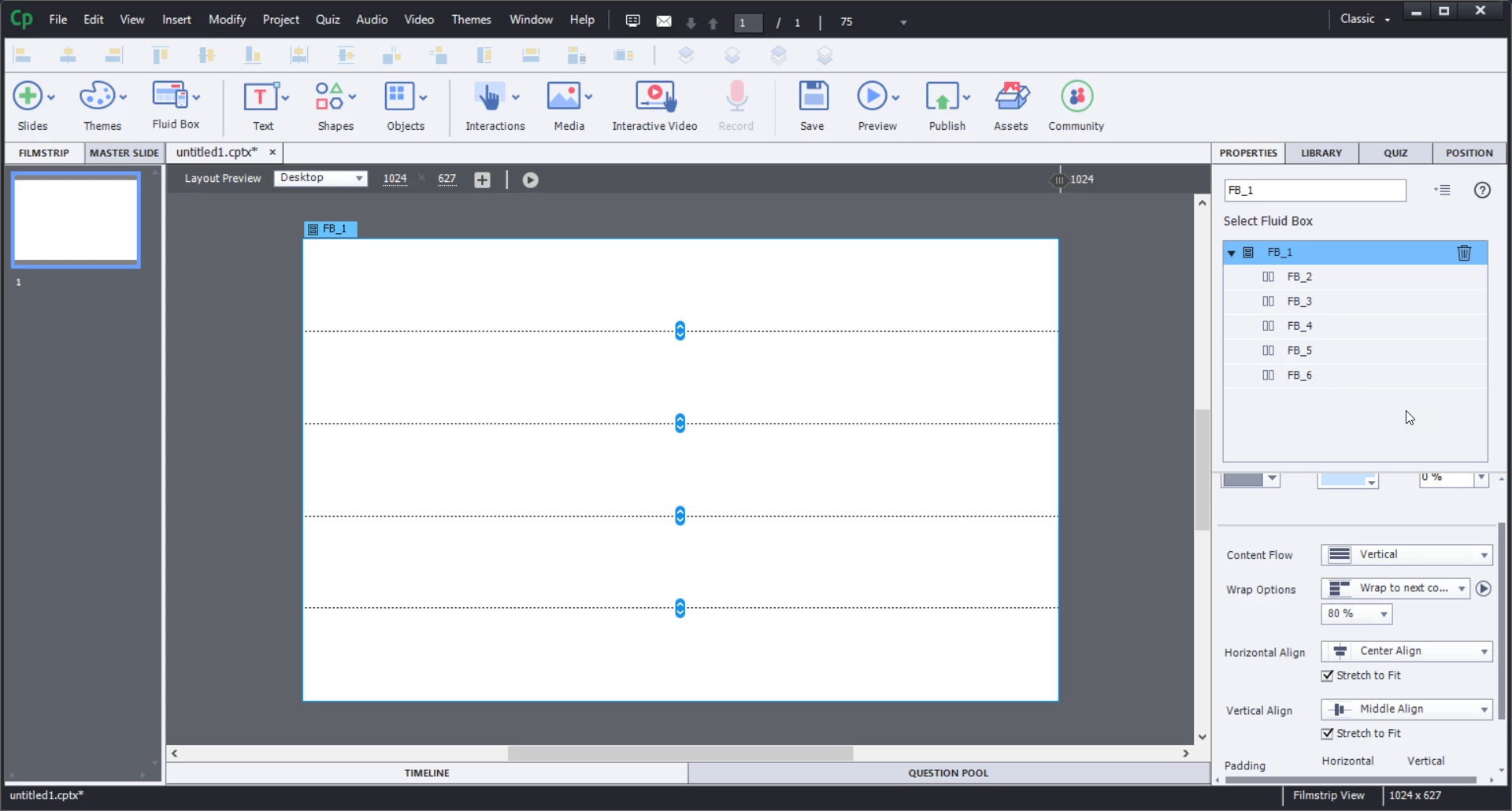

Captivate 2019 Fluid Box Google Pixel 2 Issues:

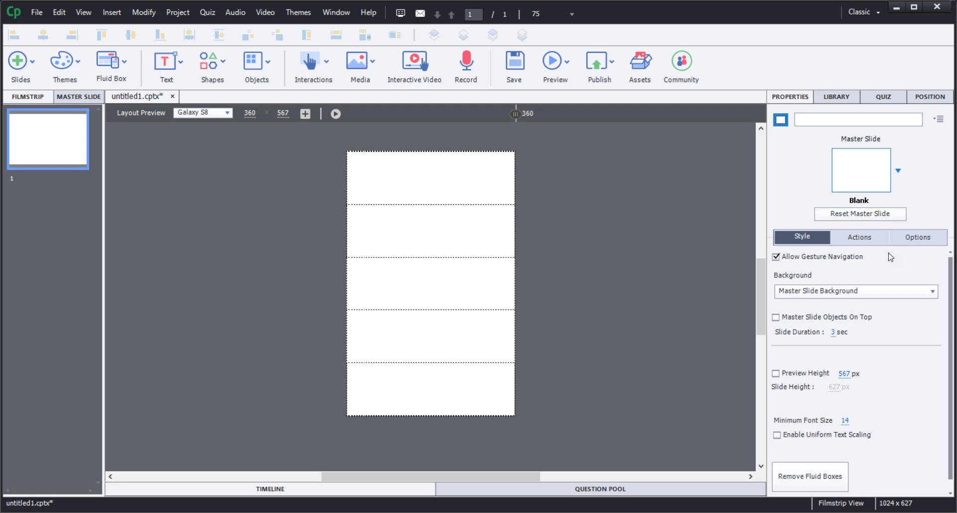

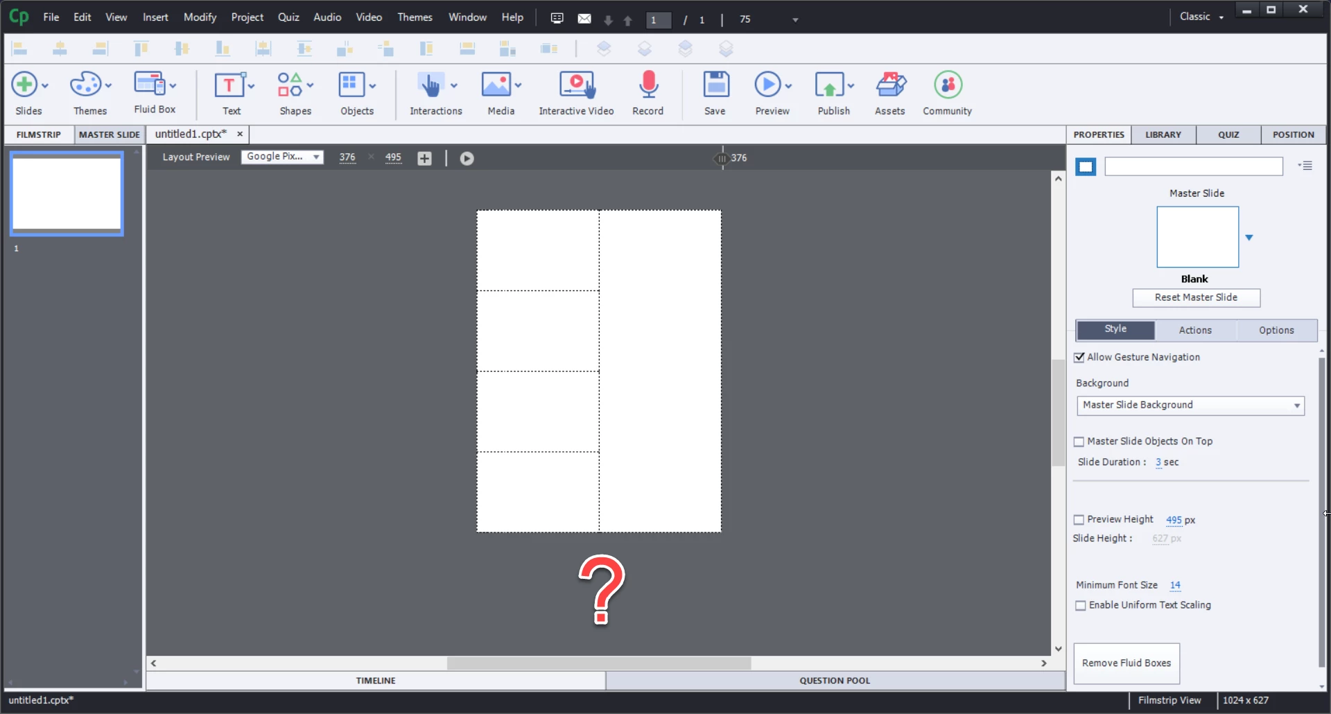

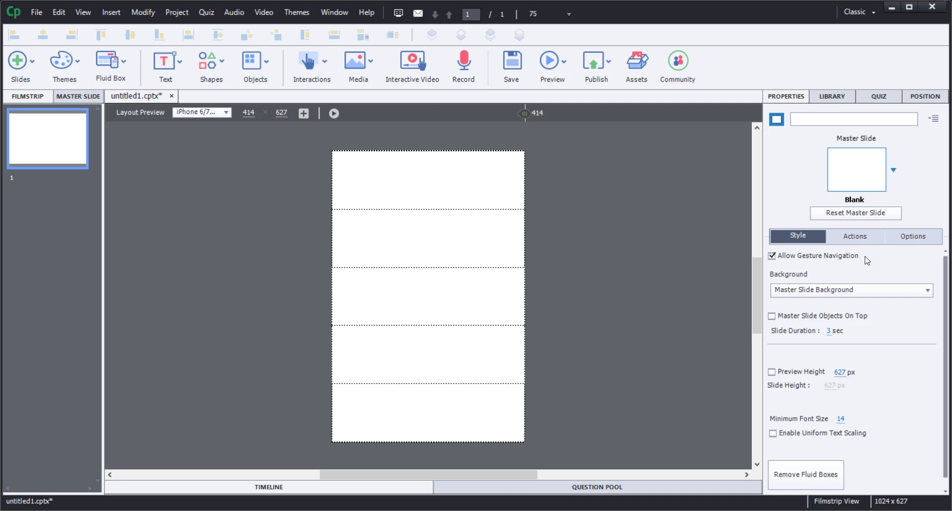

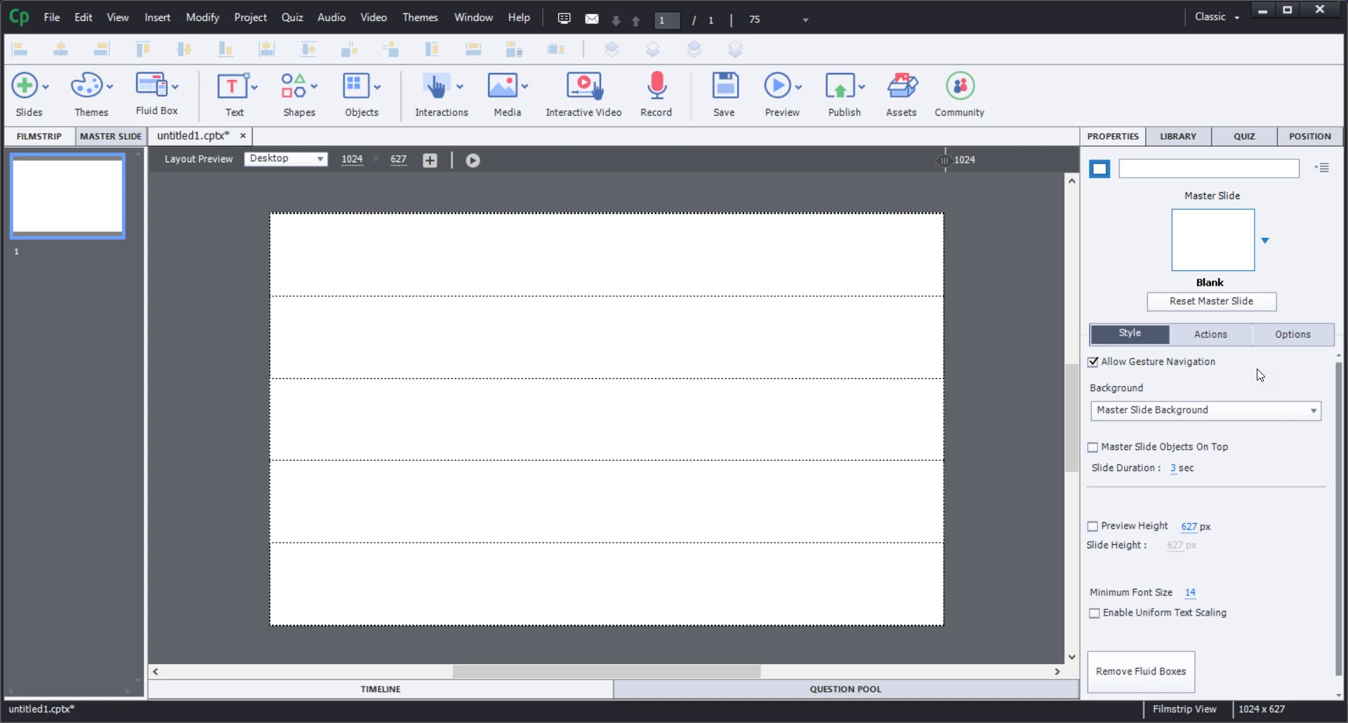

I am having issues with getting the fluid boxes to properly align up when previewing in different modes. When cycling through  the layout preview mode, everything is fine except when viewing in "Google Pixel 2", the fluid box layout is different from the other views as shown below or you can reproduce.
Scene:
5 fluid boxes "horizontally"
Q. What can be done to resolve the issue?

    iI asked for a screenshot of the setup for the parent fluid box of those 5  FB's in a column. You have to set it to 'Squeeze in a Column' if you always want to see then in one column.

    Lilybiri
    Jan 6, 2019 9:46 AM UTC

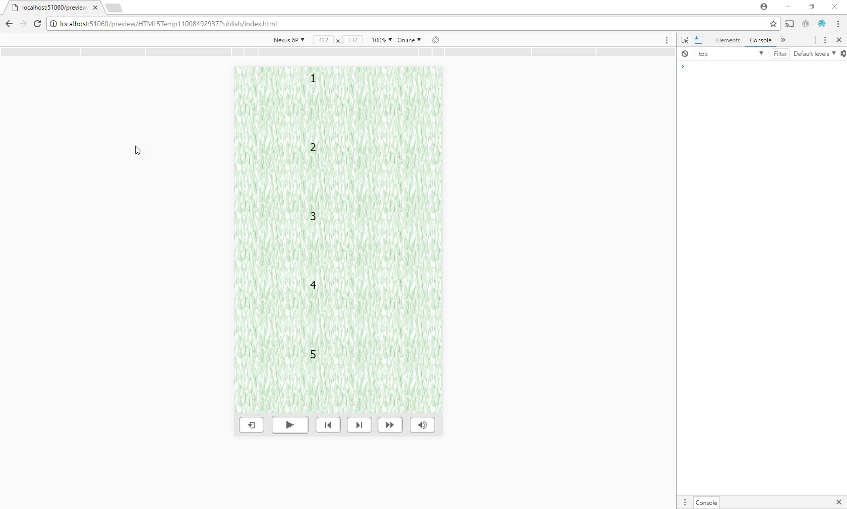

    Rod is correct about the Editing mode slider, you would better check with a real Preview mehtod.
    Can you show the setup of the parent fluid box of those 5 fluid boxes arranged in vertical way in the primary view?

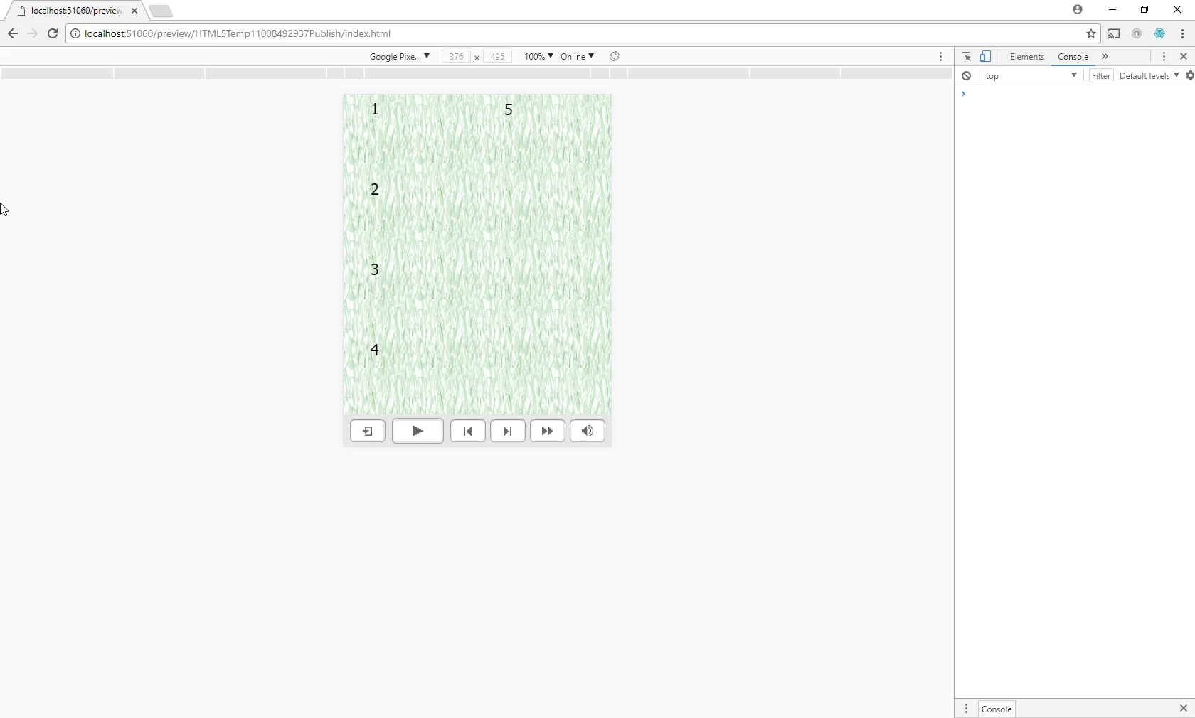

    I do not have the actual device to test, however the only resemblance is through a web browser as shown below.

    LilybiriCorrect answer
    Jan 6, 2019 9:04 PM UTC
    Sorry, I don't download files.
