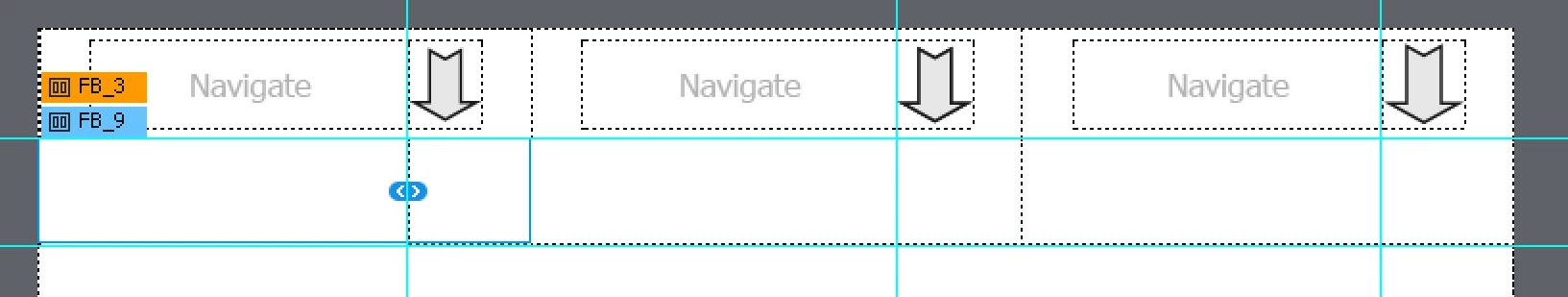

    OK, did some testing and understand what you mean, when copy/paste the shape it will extend to the size of the fluid box.
    Only workaround I found is to split the fluid boxes which have Navigate and the Shape in two horizontal fluid boxes, set to squeeze in a row so that they remain linked in any view. The fluid box for the Shape will need some padding (in this screenshot I used 5px vertically and horizontally):
    Now you can copy/paste the shapes, they'll get the same size. The cyan lines which you see are guides.

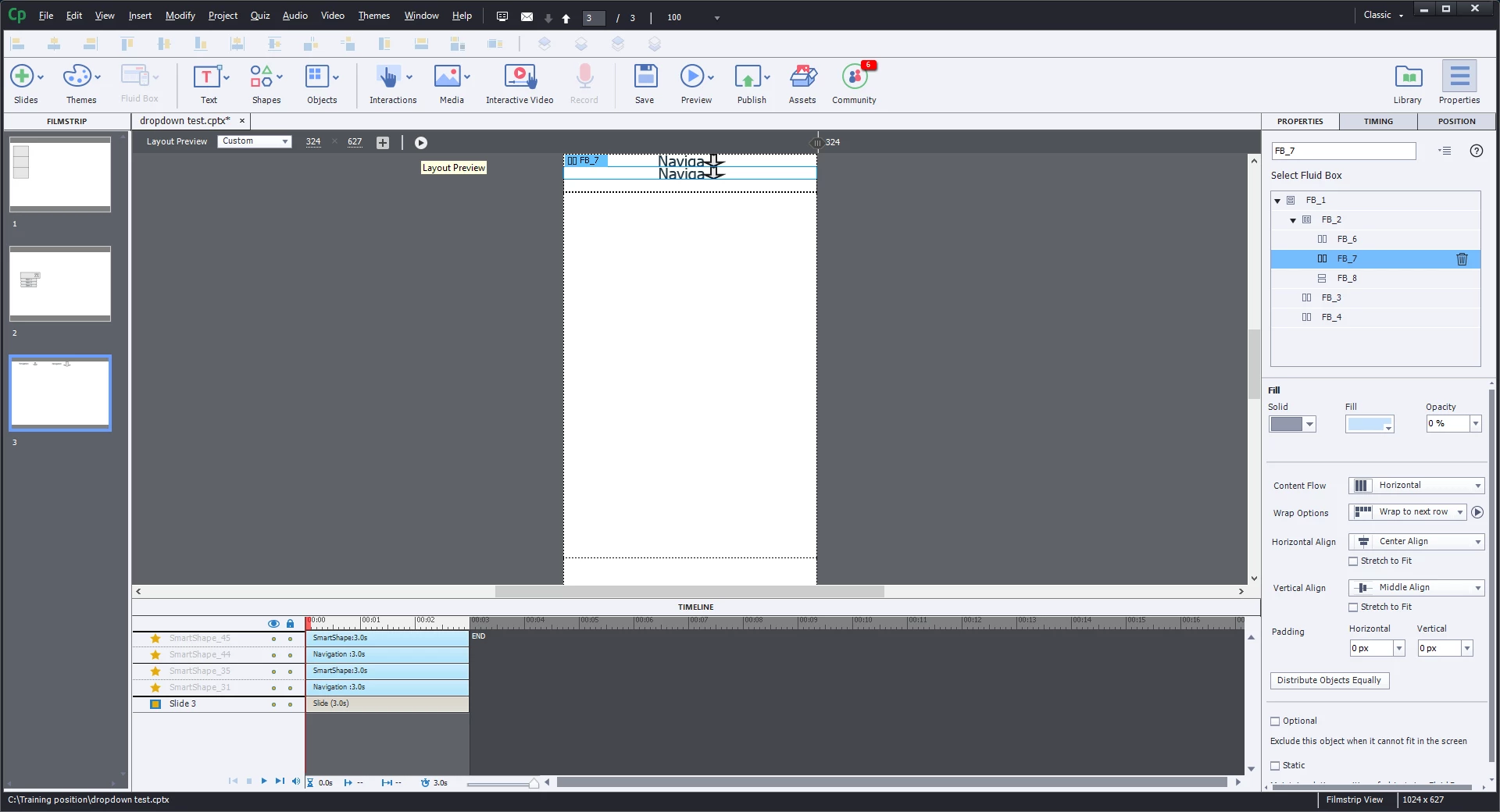

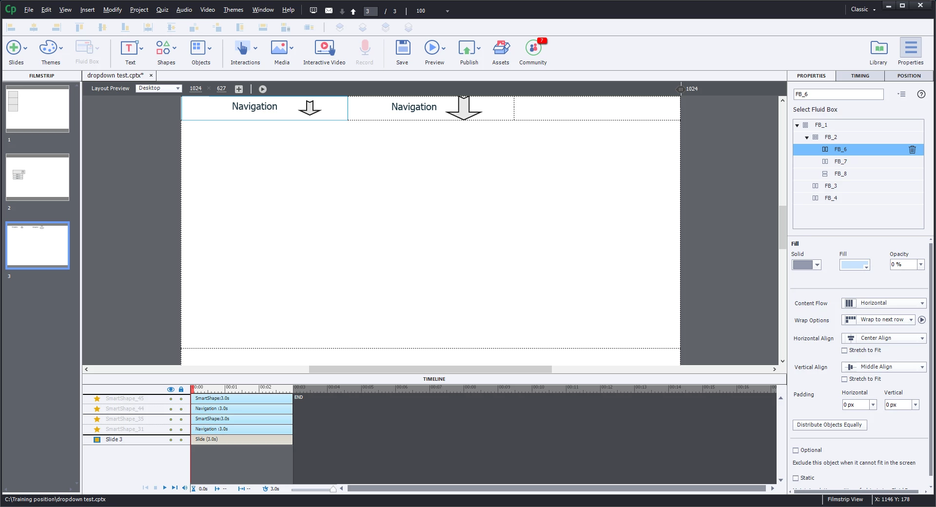

    Thank you for the reply. I thought the dark bars separating the two sets of smart shapes indicated that they were inside a fluid box. Is that correct?  Here are the images of FB6

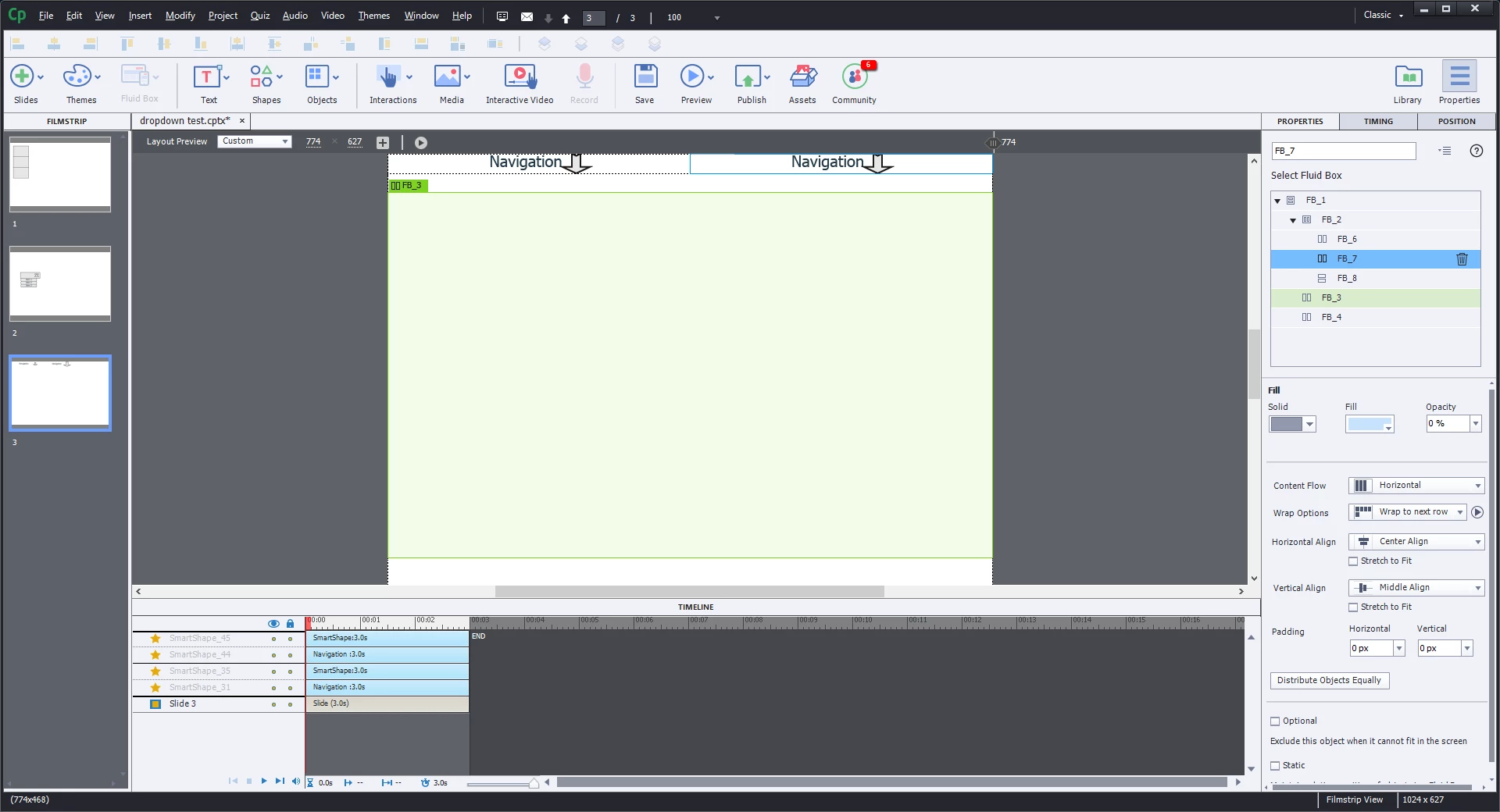

    Here is FB7:

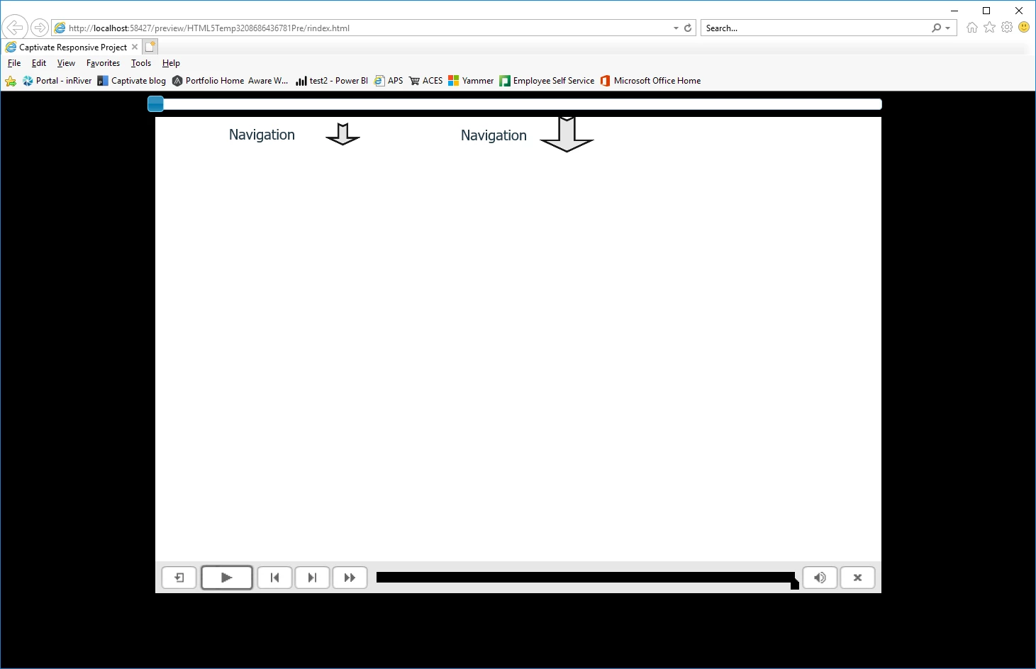

    Here is the run.
