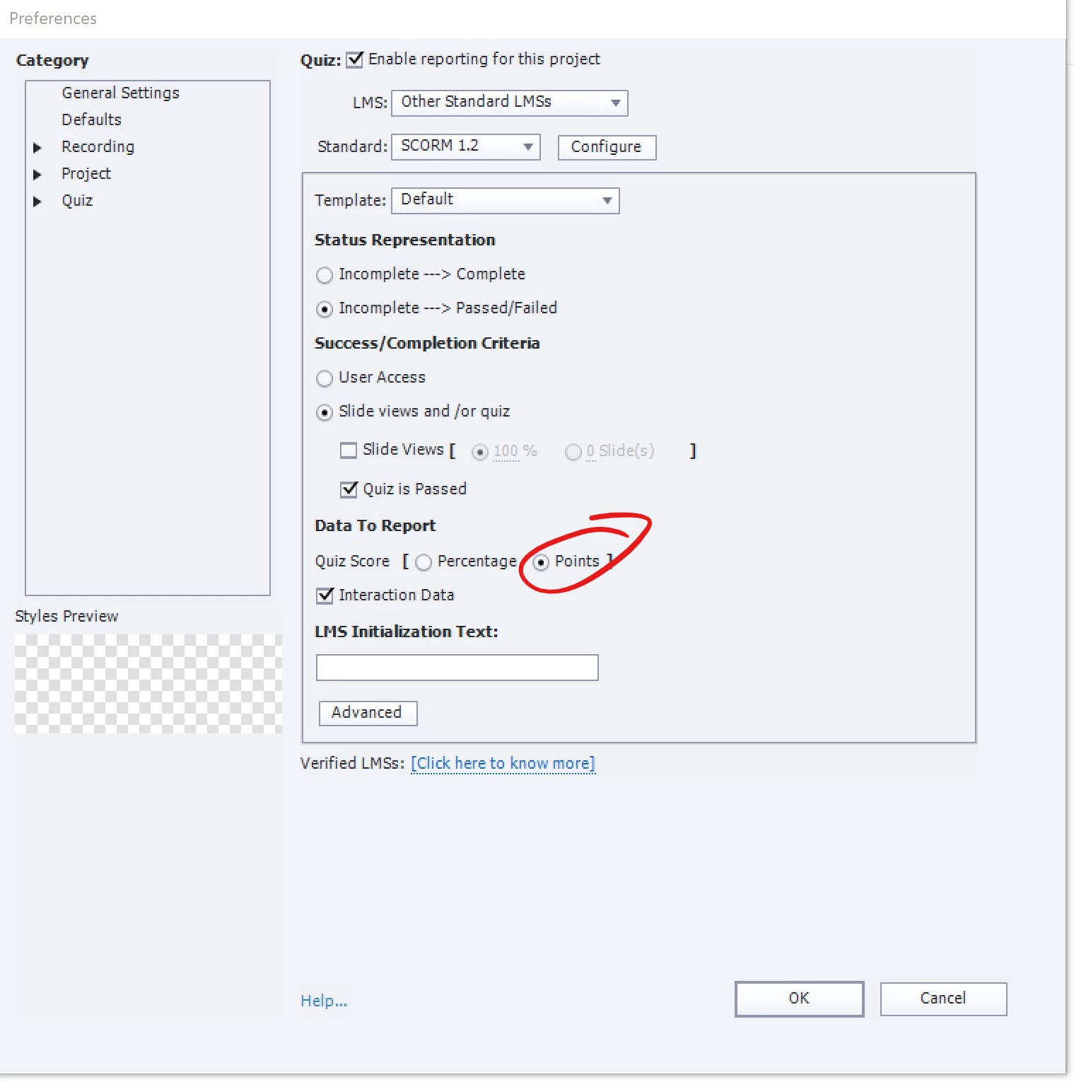

mlisonbeeAuthor
Aug 27, 2020 2:54 PM UTC
I changed it to report points instead of score and it fixed the  issue.

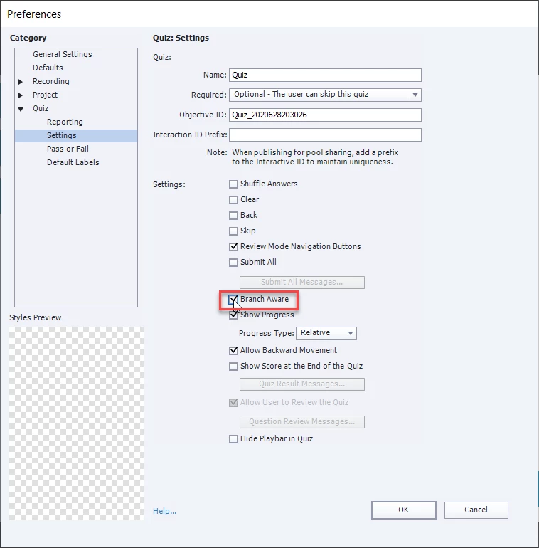

If there is the possibility that the learner might not see all slides in your project due to branching, you may need to enable Branch Aware.
  1. Press Shift+F8 to open the Preferences window.
  2. Click On Quiz > Reporting and enable Branch Aware
This will ensure that users are not marked incorrectly for slides they don't navigate to.
Paul Wilson, CTDP
