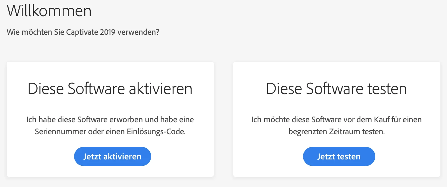

    Unfortunately not - after login with my Adobe-ID captivate ask me, how i want to use the software:
    Lilybiri
    Mar 18, 2020 4:40 PM UTC
    Are you logged in with the Adobe ID? Choose 'Diese Software testen!'. Normally it will be activate on your ID. If that is not happening, something is awry with your account. In that case, I cannto help you because I am just a user (with a subscription license). Only can try to find a staff member, but try first what I just told.
