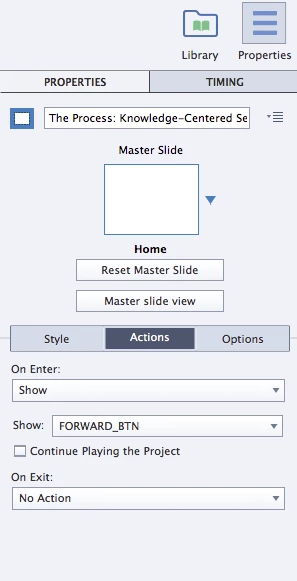

I had the same problem (animations working in timeline preview but not in any other preview mode) in Captivate 2019 and I figured it out. For me, it was due to an On Enter Action. I had an On Enter Action to Show something. There is a checkbox option below that was unchecked called "Continue Playing the Project" (see screenshot). Once I checked it, all my animations worked flawlessly!
