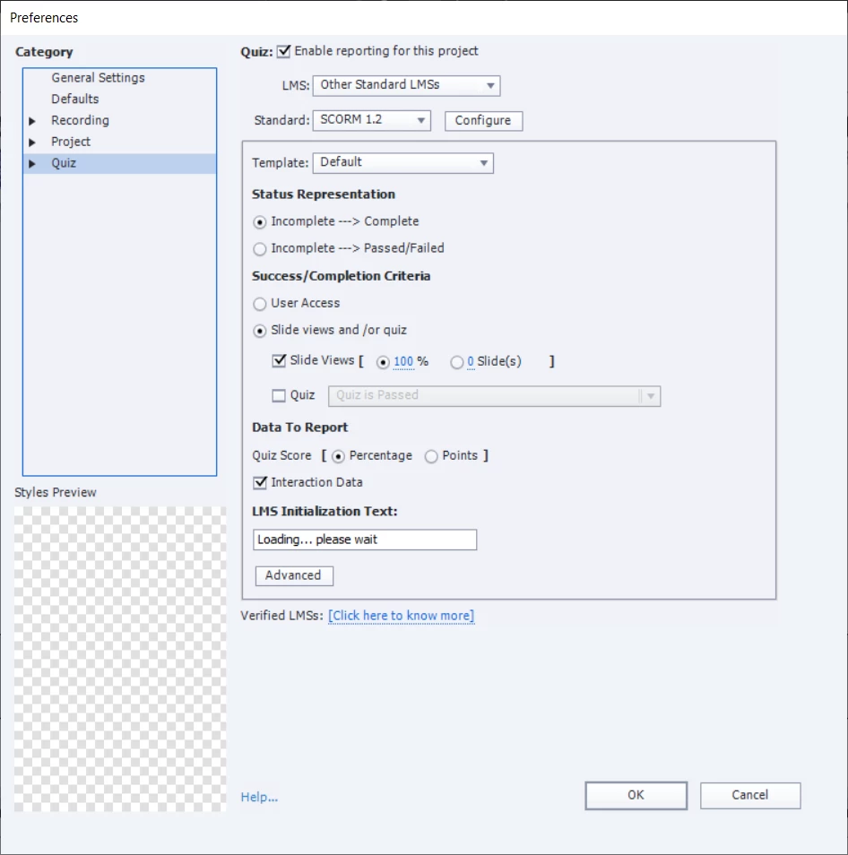

Do you have at least one slide after the score slide? Could you insert a screenshot of the Reporting secion under Quiz Preferences?
stevej89009549
Jan 22, 2021 10:22 AM UTC
Thank you for replying so quickly.
No the score slide is the last slide in the assessment module.
I have attached a screenshot of the Reporting section under Quiz Preferences.

Please add an extra slide, maybe with an exit button or congratulations. I had several consultancy jobs where this was needed as well.
Moreover, depending on the LMS interpretation of 'slide completely viewed' your criterium of '100% slide views' may also be a problem. It is not consistent, that is why I refer to the LMS. You do have a quiz, since you have score slide. Is it not possible to use one of the Quiz options for the Criterion (there are 3 possibilities) instead of Slide Views.
