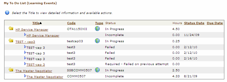

I'm trying to build a course in Cap-3, using the TEDS LMS (SCORM 1.2).
The course runs fine, but is not sending the scores to our LMS.  I'm not the *most* techincal of folks, but I want to exhaust my troubleshooting first.
Here's what I've tried.
First:
Screen shot of the repeated failures (quiz is a generic 2 question quiz):
It's a little hard to see, basically it shows my three quiz results with "Failed" after each.
Each time I took the quiz, I passed with 100%.  I set the pass threshold to 80.

I've not lookede through the previous thread, but you've done variations on the settings?
You have tried Pass/Fail instead of Complete/Incomplete? Generally, if you want a score to show, you need to use Pass/Fail. That's not always true, but a score is generally not associated with Complete/Incomplete in SCORM 1.2 (in my understanding).
Have you tried the lesson through any test suite outside the LMS itself? That'd be my next step. The ADL Test Suite is the 'offical' tool for such testing but isn't very user friendly. Otherwise I'd suggest Rustici's Test Track
http://www.scorm.com/scorm-solved/test-track/
or the Reload Editor (which I've not used and am not 100% sure is for SCORM validation)
http://www.reload.ac.uk
Run the lesson through some SCORM tester and see if the values passed are what you expect. If not, change the settings, publish, and test again. A lot more efficient, hopefully, than going through the LMS itself and allows you to possibly determine an LMS issue over a lesson issue.
HTH
Erik
February 17, 2010
Erik,
Thanks for the reply, the Test Track website is a huge assett for my troubleshooting needs.  I was able to upload my course and see that, according to the site, it's generating both the "Completed" and "Passed" marks that TEDS requires.  This allowed me to call back TEDS support, to get some additional assistance on their end.
