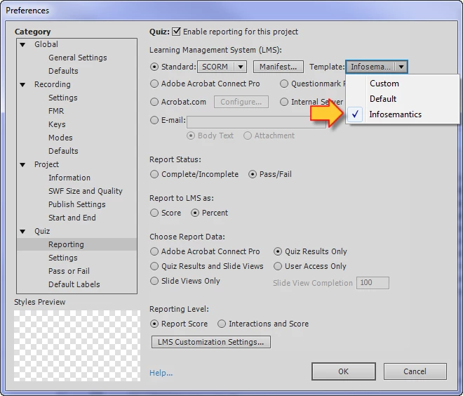

Mine was with Captivate 5, and was caused by Adobe adding extra options in the Report Data preferences, then defaulting to their own ConnectPro.
All the tests I've run today, with almost any setting BUT ConnectPro, work.
My thanks to ckenisell1 - it was the screenshot you included in your original post that caught my eye and pointed me in the right direction.

@ckenisell1   I was just looking back over some of these posts and noticed that I never did show you how to get your customised HTM SCORM template to be visible inside Captivate's Quiz Preferences drop down.
All you have to do is go to:
C:\Program Files (x86)\Adobe\Adobe Captivate 5\Templates\Publish\SCORM\1_2  (for SCORM 1.2)
or
C:\Program Files (x86)\Adobe\Adobe Captivate 5\Templates\Publish\SCORM\2004  (for SCORM 2004)
Copy and rename the Custom HTM template from within the folder and give it a name of your choosing.  Then make the modifications to this file that you want to be in effect every time you use it.
When you next open the Prefences > Quiz > Reporting dialog and select Enable Reporting > Standard > SCORM you'll be able to see your new template file in the Template drop down menu.
