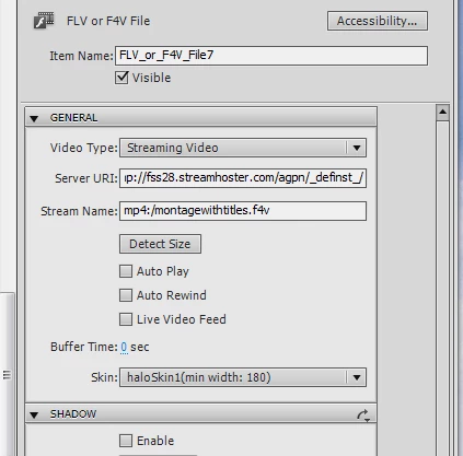

I have tried this thanks Mark, still no luck, nearly two weeks trying to ge the streaming working, how can this be so hard?
I converted a file to F4V and still no luck.
I can stream to an online FLV player with this link, all fine, but place the link into CP 5.5 no go.
rtmp://fss28.streamhoster.com:1935/agpn/_definst_/montage_without_titles.flv

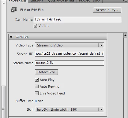

I have been trying to get streaming working within CP5.5 to no luck. I have tried both streaming and progressive download, exported to scorm and tested in scorm cloud, neither work.
I am hosting FLV files on Streamhoster and the URL they supply with the FLV is rtmp://fss28.streamhoster.com/agpn then stream name is ( scene1.flv ) but this doesnt seem to work. I have 9 FLV files to play throughout the project, they are not scored just played on certain slides.
