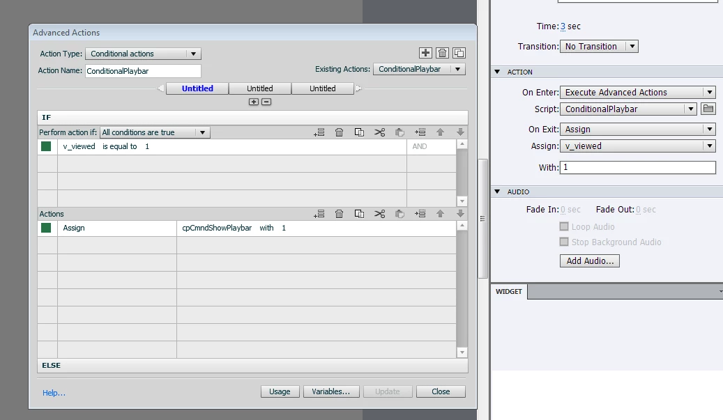

    So I've gone through and set it as you specified.
    This is set on all slides
    This is set on the final video slide.
    The Playbar does not show for the first slide.  Great.  However one all the other video slides the playbar returns??  Any idea why this may be?

    Did you set the value of v_viewed, when definining it, to 0? And sure that you did assign the conditional advanced action to all On Enter Events, for all video slides?
    You didn't show the ELSE portion of the advanced action, where the playbar is hidden.
    To debug: put a text container (either a caption or a shape) on the first slide in which you insert the variable v_viewed. And time it for the rest of the project: its value should remain 0 until reaching the quiz slides.
