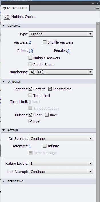

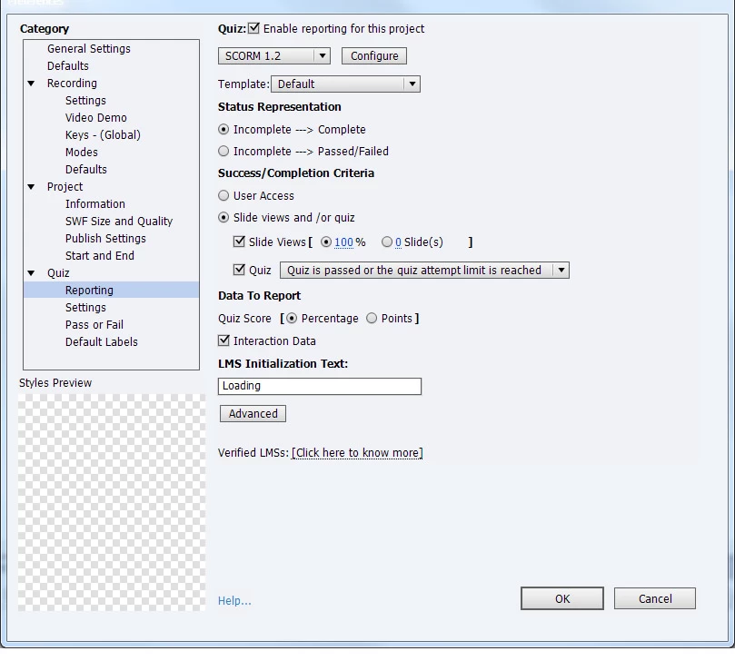

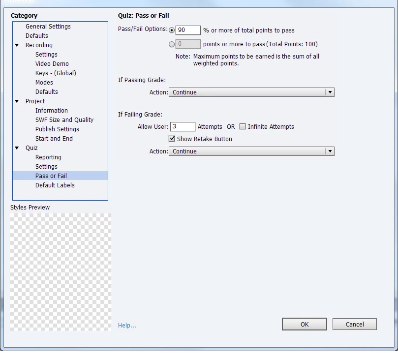

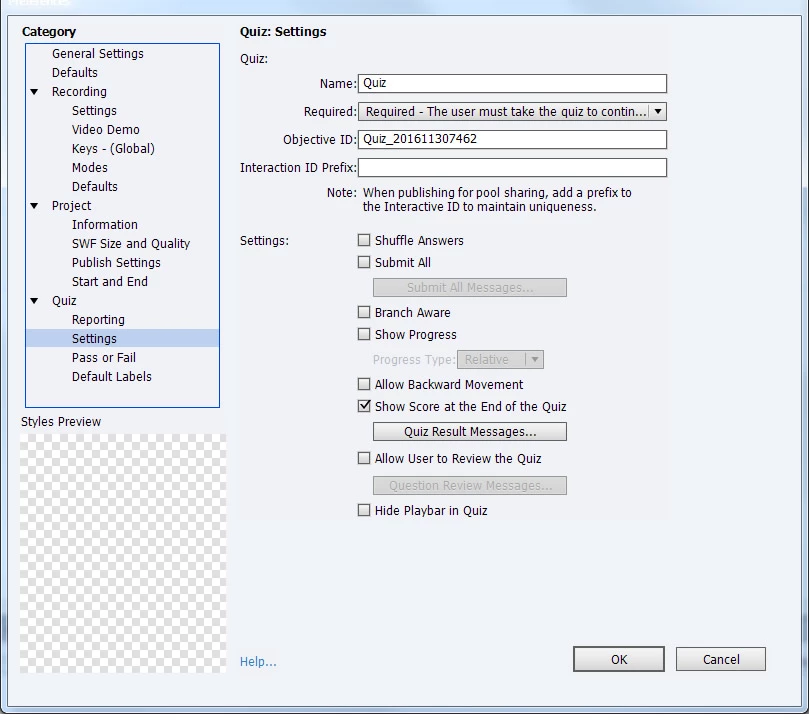

  3. What are the actions for Failing grade and Passing Grade? Please see screen prints:

I suspect that the 100% Slide views criterion is the culprit. A slide is only be viewed when all frames have been visited. It is very possible that you have buttons somewhere that will jump to another (or next) slide, which means they'll jump over the frames of the inactive part of the buttons, and all frames are not visited.
Moreover, the Required option is very strict. Can you test if putting it back to 'Optional' gives you a better result? There are other ways to push the user at taking the Question slides. If you do not provide the Next/Skip button, and don't allow them to use the progress bar in a playbar in the quiz, they have to answer each question. Same with score slide.

What do you mean by 'this is working'? Did you set up the Quiz Preferences to 3 attempts? What are the actions for Failing grade and Passing Grade? How did you set up the Reporting, which SCORM version?
