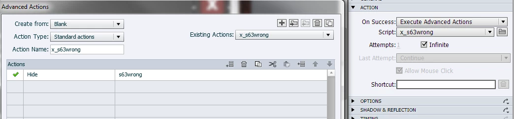

Hi there!
I added a drag and drop question to my project to create a multiple response question.  There are 6 draggable objects and one drop target.  User must drag the correct 4 objects to the drop target.
If they do not select the correct 4 objects, I would like a lightbox to appear with feedback and an instruction to try the question again. User must X out of the lightbox to see the question and try again.
  • I created a group (text box with feedback and close button) for the light box
  • I also created variables
    • Variable1:  Show group
    • Variable2:  Hide group
  • The close botton has been assigned variable 2 (hide group) on success
In the drag and drop properties, under ACTION, I selected
  • On Failure:  Execute Advance Interaction
  • Script:  Variable2
I thought that this would prompt the lightbox to appear, but it does not work.  I must be doing something wrong!  Can anybody tell me what I did wrong and how to get the lightbox to work?
Thanks

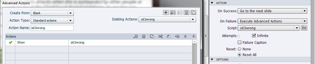

Yeah, the Drag and Drop interaction could be a bit more rigorous. I think I see a way to make your interaction work as you want it to. I am wrestling with a similar scenario. Here is what I have played with...seems to work, might need a bit more tweaking for a smooth appearance, but it is not bad at all.
Set D&D On Success as desired (Next slide...whatever). Set On Failure to Execute Advanced Action. Create an Advanced Action to Show your lightbox group. Create another Advanced Action associated with the close button on your lightbox. That advanced action will both Hide the lightbox message group and Jump to the slide immediately preceding your Drag and Drop slide. You will create that preceding dummy slide to look just like your Drag and Drop slide, but with no interaction at all. This new dummy slide allows the D&D interaction to reset each time there is a failure. Set the dummy slide to display for a split second before forwarding to your true D&D interaction slide. If you build this slide to match your D&D slide exactly, the transition should be imperceptible.
Also, set your D&D No. of Attempts to 1 and turn off Failure Caption, as you have created a lightbox group to serve that purpose.  Seems to work great when I try it. For the learner, a Fail triggers the lightbox. When the lightbox is closed, the D&D interaction seems to reset and start again smoothly.

April 2, 2014
You seem to misunderstand how variables, runtime events and actions work in Captivate.
Your Close button doesn't get assigned a variable called SHOW group.  It can execute an Advanced Action that SHOWs or HIDEs a group with a given Item Name.

April 2, 2014
Hi RodWard,
I'm sorry I'm not using the correct terminology.
My problem is not with the close button - I created a hide variable that works perfectly when I click on the close button.  That is, it hides the lightbox when clicked (or "exectues an advanced action" to hide group).
What I am looking for is a way to show the lightbox in a drag and drop interaction when user does not drag the correct objects to the drop target.
RodWard
April 2, 2014
OK.  The bit you're not understanding now is the way Infinite Attempts works in Captivate.
Take a look at this post to get the concept:
http://www.infosemantics.com.au/adobe-captivate/infinite-attempts-means-infinite-unsuccessful-attempts
Since you have Infinite Attempts selected for your drag and drop operation, your On Last Attempt action will NEVER get executed.
