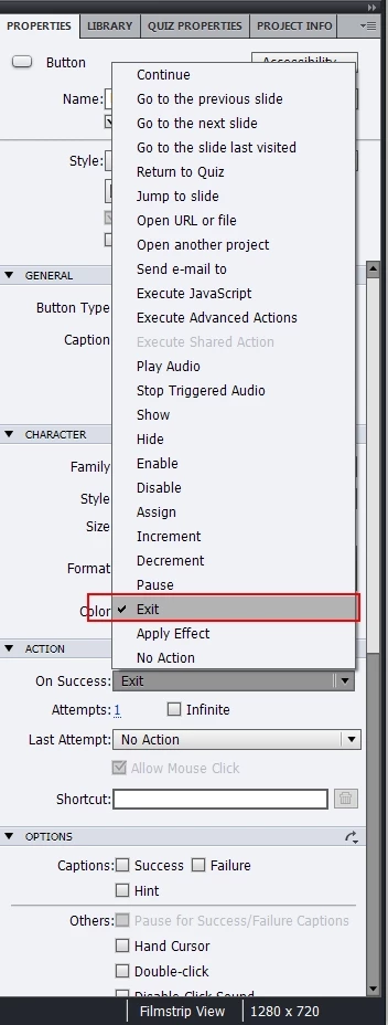

Captivate 7 now has a pre-built 'exit' function so that you don't have to add any custom script, meaning that you don't have to worry about browser compatibility.
After selecting your actionable object (button), in the 'Action' section, under the "On Success" drop-down, select exit. It's that simple.

I don't think this will address the overall issue though. The problem most folks seem to have is when their CP lesson is launched within a frameset within a new window (though that may not be obvious to the user)...
CP's Exit function doesn't account for that. Jevon's fix allows it to find the proper 'hierarchy' to properly close the window.
So unless Adobe changed the actual JS function behind the Exit option they provide, it's the same issue.. Just selecting a different Exit option likely is not a fix.
