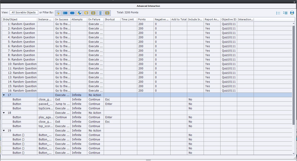

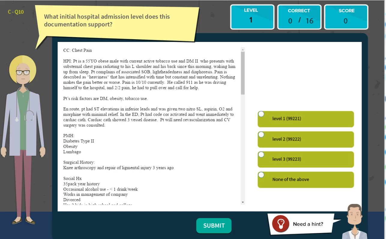

We are trying to display a quiz score (on question slides) using $$cpQuizInfoPointsscored$$. See the upper right in the image.
All of the questions have a score of 200 associated with them:

Screenshots are all from "Level 3."

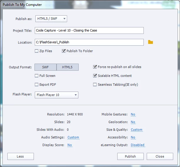

All of the publish properties are the same for the three files:

  • Random Question (Question bank) slides - have (1) On Success: Go to the Next Slide action, and (2) Last Attempt: Advanced Action that displays a button on the slide and pauses the slide so that the learner can review the question before moving forward
  • Question slides - have On Enter: Advanced Action which hides the button that gets displayed/pauses the question slide if they get the answer incorrectly

    You talk about an advanced action on the question slides to show a shape button. Did you perhaps delete embedded objects on the question slides or mess up the default design? I cannot figure that out from the examples but it feels like you could have done that.

    Each question includes a submit button, 2-4 responses, correct shape, and incorrect shape. The back button is turned off (as you can see in the settings below). The questions also do not include a clear, next, or incomplete shape.

    Like Rod points out, and as I warned in my previous answer: you apparently did delete embedded objects.

    Just looked again at the screenshots of an example quiz question slide in your original post and it made me wonder if perhaps you have by any chance replaced the default Question Title or Question text captions with different objects, e.g shapes.
    When you first insert a new quiz question slide into Captivate it has a Question Title caption at the top that tells you what type of question it is (e.g. True/False or Multi-choice) and a Question caption that you edit to show what the learner needs to answer.
    Most Captivate authors don't realise these captions are actually essential to correct functionality of the quiz question and sometimes delete them and replace them with other objects to make their question slides look a certain way.
    Have you done that here?
