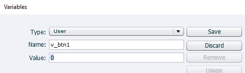

    If I have 3 buttons that I want the user to click, I need to create the variables v_btn1, v_btn2, v_btn3 (or whatever makes sense to you). Assign each a value of 0 when you create them.

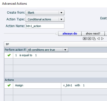

    For each button, you need a conditional advanced action that will:
    1. assign the value of that button's variable to 1 when clicked

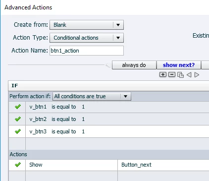

    3. in a second decision tab, test IF v_btn1 == 1 AND v_btn2 == 1 AND v_btn3 == 1, THEN show the NEXT button

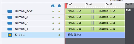

    Set NEXT button visibility to hidden
    Create variables
    First tab of a conditional advanced action (I use Captivate 9 - Cap 2017 looks a little different). Add in all of the other things that the button-click will always do.
    Second tab of the same action
    The timeline - all pause points of the buttons are aligned. If you have audio or animations that take time, you might have to adjust the timing of the NEXT button.
