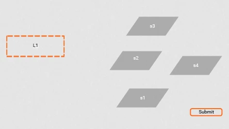

The stage (yes, this is just in test phase at the moment)

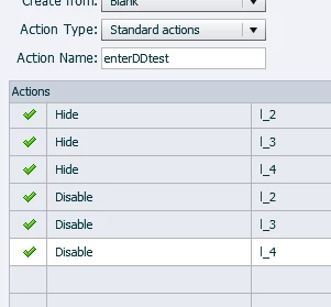

Slide entry AA

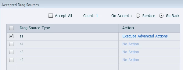

Setup for target l_1 (all other targets follow this model)

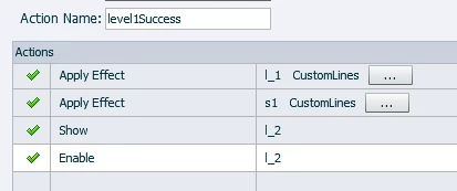

AA when s1 is dropped on l_1
