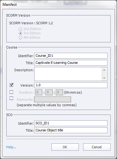

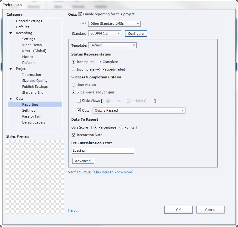

It sounds like you're publishing and testing locally, and then trying to upload the zip file to a server for review, is that right?
1) Check your server to see if the unzipping has completed, we had a 10 minute process suddenly take 4 - 6 hours last week and were ONLY INFORMED of this when we called for support.
2) Try publishing your zip to SCORM.COM with a free account, it will give feedback if the zip causes errors.
3) Try publishing the Cp file as HTML to a folder, and zipping the folder yourself.Upload that to SCORM.com and your server for testing.
4) Revisit the SCORM setting dialogues in Cp and compare with the target LMSs settings.
Project Info -> Quiz Reporting:
Click configure:
Underscores indicate NO SPACES ALLOWED.
Any difference?
