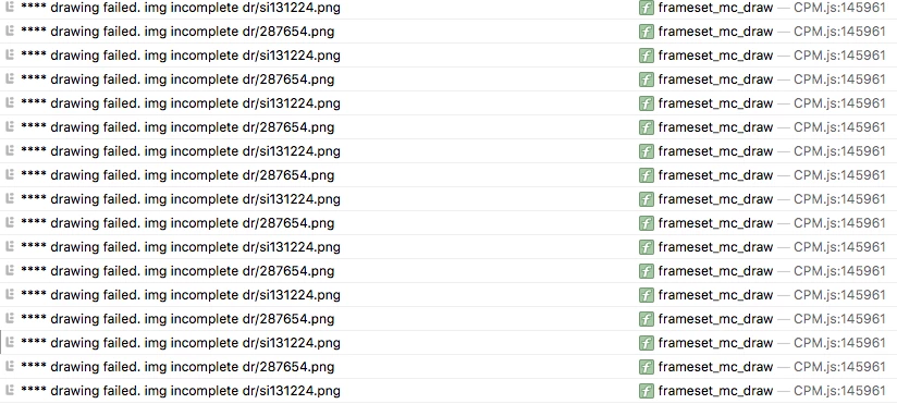

    May 3, 2017 1:07 PM UTC
    Thanks RorWard! for your quick response!
    Yes, We have tested from Moodle LMS and Reload SCORM player.
    Please find below Screens shots:
    Thanks in Advance!

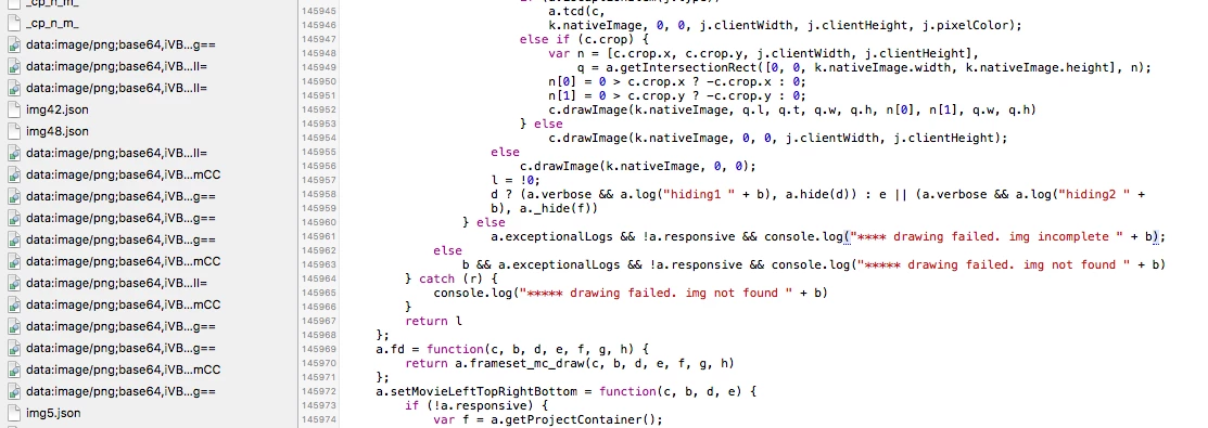

    RodWard
    May 3, 2017 1:36 PM UTC
    I said test in SCORM Cloud, not Moodle.
    My suspicion is that your LMS web server is not set up to allow the JSON filetype.  I know that SCORM Cloud DOES have this setup.
    If your content plays fine in SCORM Cloud, you need to go back to your LMS web server administrator and ask them to enable the JSON mimetype.  That filetype is now used for Captivate's HTML5 output to render images such as PNGs.  Your error messages indicate issues with PNGs not being found.
