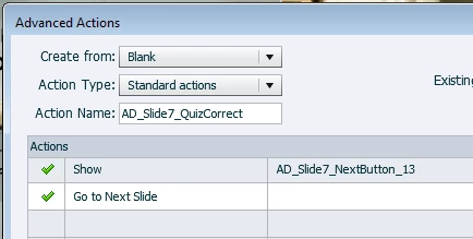

I was able to create two simple advanced actions that run when the submit button is clicked. If the learner succeeded, the action is to show the SmartShape Next Button (coded to 'go to next slide) and then go to next slide.

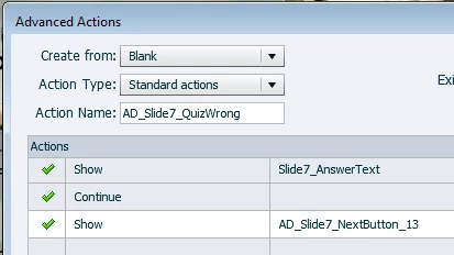

If the learner fails (after 3 attempts) the action shows the answer text box, the SmartShape Next button and continues the slide (which gives enough time for the learner to read the answer text).
This solution works in that the next button does show on the slide if the learner is right or wrong, but it locks up/freezes the buttons on the following content slide until the module is exited and reopened. I'm assuming this is most likely due to the advanced actions breaking the quiz logic somewhere?? .

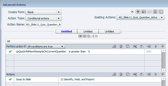

Thanks L!  I didn't care when on the slide it appeared, really, I just wanted it to be usable if the user ended up on the slide again. What I ended up doing removed the need for trying to put a button on a quiz slide. Just in case anybody trips over this post in the future, what I ended up doing was to program an advanced action for the next button on the previous slide to check a system variable to see if the quiz question had been answered
If it was answered, it jumped to the next content slide. If it had not been answered, I told the button to go to the quiz slide. This solved both issues of making users answer the questions as well as being able to navigate back and forth.
