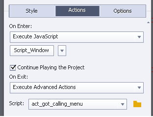

I have a project called MENU.
On Slide 1 I use On Enter to run some JavaScript to pick up a 'myCallingMenu' variable stored on the hard drive.
I then use the On Exit to run an Advanced Action.

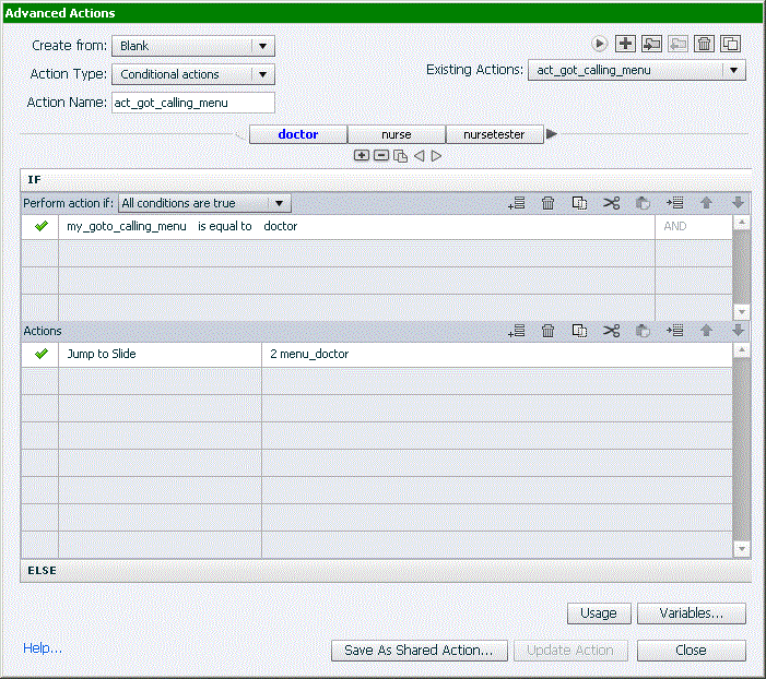

The Advanced action uses IF statements to jump to a slide based on the value of the variable myCallingMenu.
All this works perfectly when I publish as HTML5.
and
All of this worked perfectly published in SWF when I only had 16 IF statements.

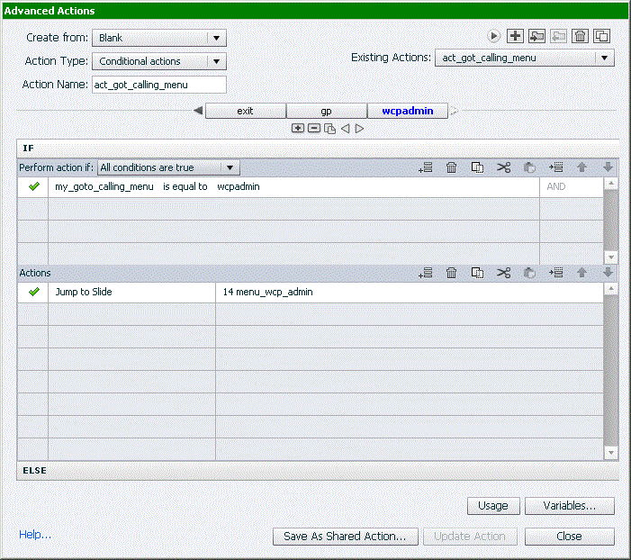

I then added a 17th IF statement to jump to a new slide.
Now...
All still works perfectly in HTML5
However, when I publish as SWF, the Jump to Slide 1-16 works, but the Jump to Slide 17 fails.

IF numbers 1 - 16 (all works perfectly in HTML5 and SWF)
IF number 17 (Works in HTML5, but fails in SWF)

    Can you show the 17th decision?
    On Exit event can sometimes act very weirdly, this may also be the case. The behavior of an advanced action is not always the same in SWF and HTML output. Did you really need so many decisions? Was there no better way?
