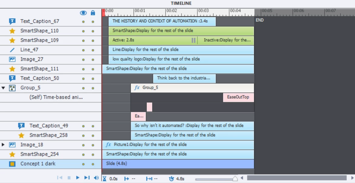

If it helps, here is a screen grab of my timeline. Please note that the "ease out top" effect on the group appearing at 3.8 seconds, after the pause at 3 seconds, starts before the pause in HTML.

You applied the effects to a group, which is OK. But I see that you made the first, and especially the second effect very short. That can cause issues as well.
As for the flickering, that is an old pain since many versions. The only workaround that helps sometimes is to add a fade in transition (has not to be too long) to those objects.
