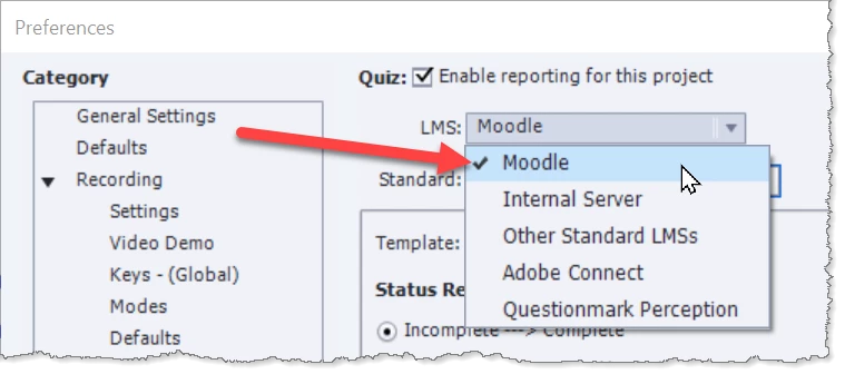

Moodle is a bit of a special case when it comes to SCORM usage and Captivate has for some time had a special drop-down menu option in the LMS settings area especially for Moodle courses.
Have you checked with the Captivate developer to make sure they in fact DID use this setting and not just one of the normal LMS settings?

I am assuming we are talking about HTML5 output ONLY here, correct?
As far as I know, all you should really need to do is select this option in Quiz > Reporting.
Other than selecting Moodle as the LMS, I have only ever used normal SCORM 1.2 settings because Moodle doesn't claim to support SCORM 2004.
If you are still having issues with your current project even after using the Moodle option in Captivate, then you may need to test whether the same issue presents in iOS devices with even a very simple blank Captivate project with a singe True/False quiz question.  If that simple project works fine on mobiles, then there's something in your project that is tripping things up.
