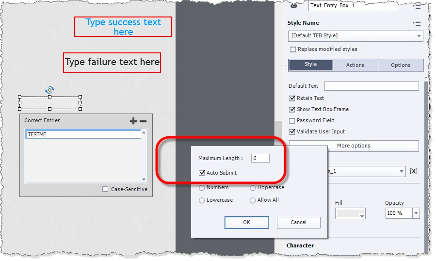

I'm currently testing a new project in Captivate 9 where we need to be able to capture the information from a text entry box that is auto submitted based on a set number of characters typed. The text entry box information should be visible on the next slide (using relevant variable name in text caption).
This works fine when previewed in browser (swf output), but fails when using HTML5 preview. Works fine in HTML5 if I turn off Auto Submit and use key press submission instead (which is unfortunately not a suitable solution in this case).
Any ideas or suggestions anyone has on how to get around this issue would be greatly appreciated.

    You sound like you would need to have the value so far entered into the TEB's associated variable evaluated automatically when a given number of characters had been entered.
    See this screenshot which shows a TEB set to automatically evaluate an entered text as soon as it reaches the maximum allowed number of characters.

    Yes, I definitely need to use the Auto Submit function in conjunction with the maximum length field, unfortunately this is where I have been hitting the problem with HTML5 output. For some reason it is not capturing the text entered into the TEB and passing to the associated variable (works fine in SWF output only breaks in HTML5).
    If however I turn this function off and submit using a button or another key the HTML5 output works fine.

    Then I suggest you log it as a bug with Adobe.  It should work the same way in both HTML5 and SWF.
