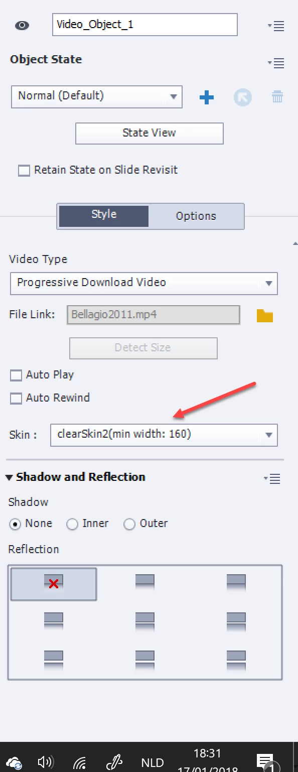

    You need to change the 'skin' of the video player.  When you import your video under 'Style' there is a dropdown menu called 'Skin'.  Choose one of the skins that has a playbar counter.

    Hi Jeremy,
    Thanks for your reply. I have tried skins such as haloskin, clear skin and so on. None of them allow me to directly click anywhere on the play bar. I have to drag the marker to desired position. It is such an old fashioned style. I don't know if they have improved it in 2017.

    You mean that you inserted a video file on one slide in a cptx-project. I hope you are aware of the fact that FLV will be abandoned soon? It is Flash-based. That is off topic, but worth mentioning.
    You probably inserted that video as Event video, which means it will get its own control panel and plays totally independent of Captivate. The default control panel has no progress bar, but you can choose another one in the Properties panel.
    If you insert it as synchronized video it will be controlled by Captivate and you can use one of the default playbars, which has a progress bar which will behave like you want. But: that playbar is for the whole file, not just for one slide.
